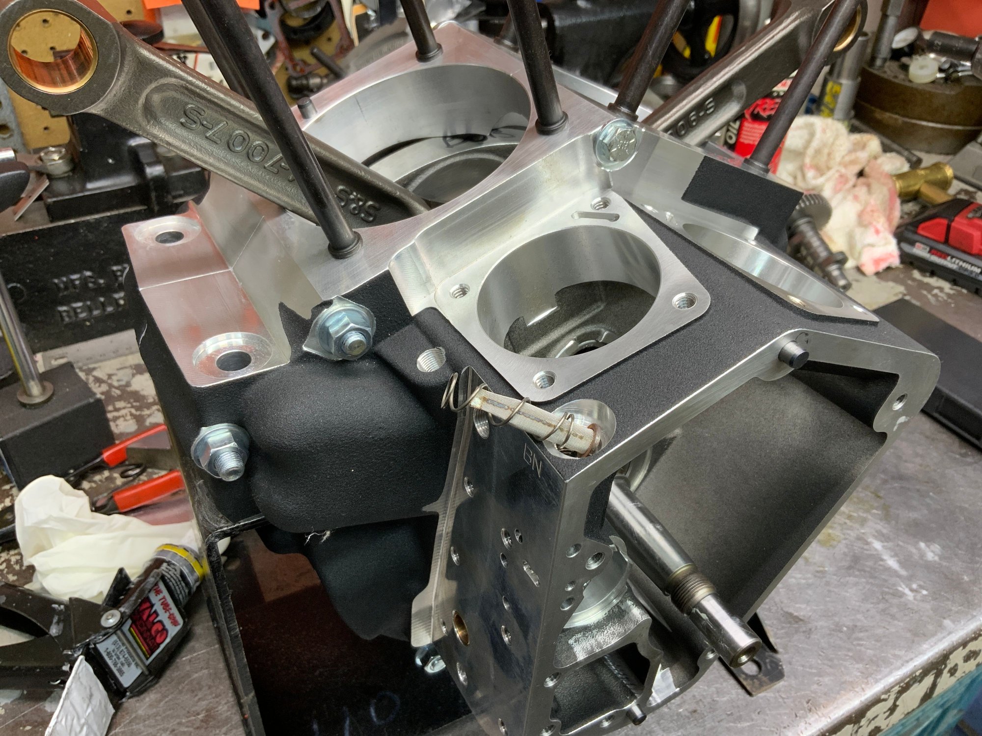

Its in the block extra filter for hydronic lifters- speed check sucks on this site - ya think
John, Correct that is the Tappet screen location. And that is where I want to install my gauge? I am at work now and will post pics later.
Thanks and looks like your having fun john.
