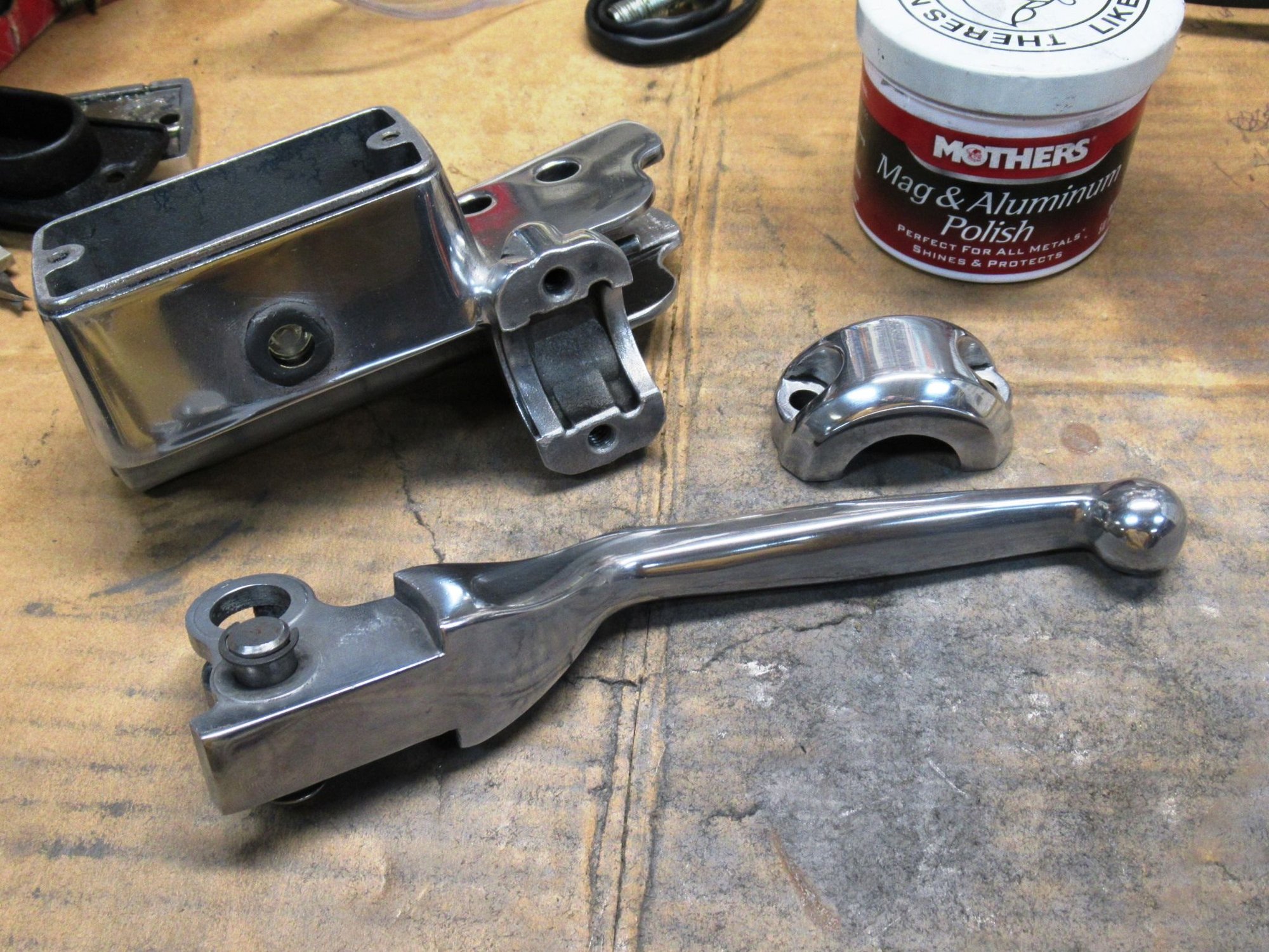

I know you said you wanted to keep your buttons, but if you change to the newer SMALLER master cylinder and matching switches, you'll have a lot more stopping power. I can howl the front tire on mine.

The master you have now is 3/4 inch - the one joe showed is available in 5/8 11/16 and 3/4 inch sizes - i dont know what one joe is using
and you need to convert to dot 5 fluid
