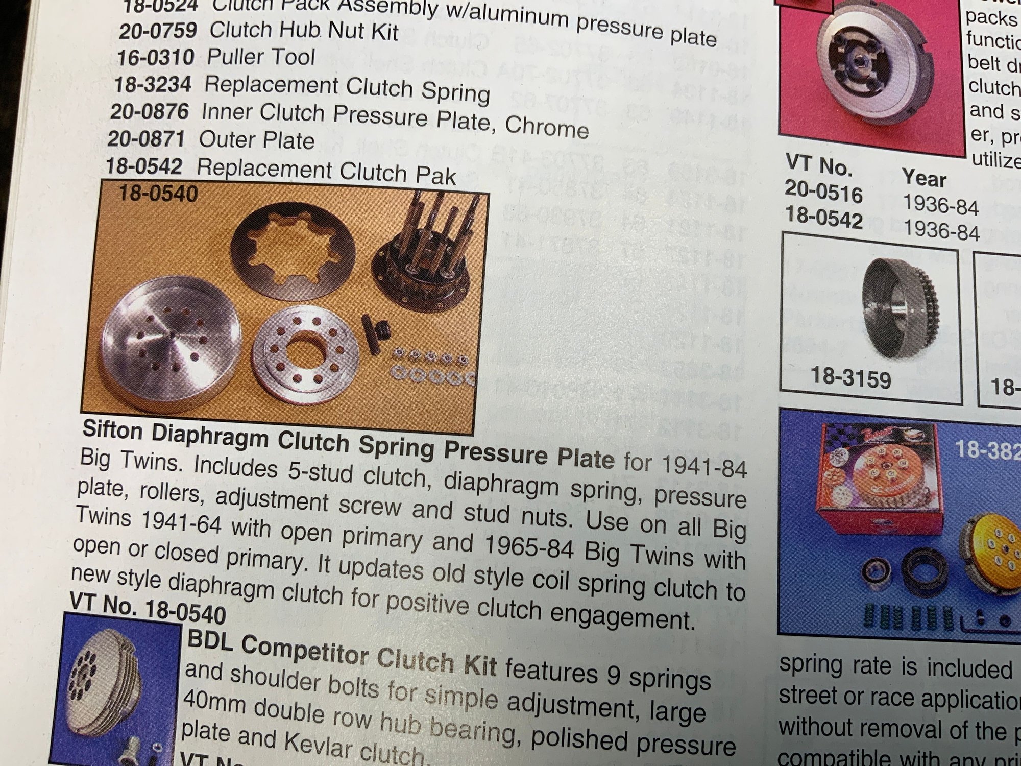

Old May 13, 2021 | 07:22 AM
Hoyt 1911A1's Avatar
Hoyt 1911A1
Joined: Sep 2017
Posts: 3,757
Likes: 934
From: Southern Virginia
Originally Posted by johnjzjz
The unit was changed this years book to include other stuff - he has always been a ***** so i am not surprised- you should put in the 5 stud ram jet retainer
Looking closer at the kit you showed there John it looks pretty cool. I never knew such a thing existed. I live in a remote rural area that doesn't have any shops left that really know old bikes so I'm way out of the loop. Roger Purgason was the guy I dealt with for years but he passed away in 2015. Does the kit you've shown here use standard clutch plates? Is it pretty much a drop in replacement that can work with the stock primary setup?
Old May 13, 2021 | 09:11 AM
johnjzjz's Avatar
johnjzjz
Posts: 12,878
Likes: 5,449
From: la la land jerzey
We only use the red alto discs and the spring and ball steels we remove them as well or buy the ones with out depends on your money
alto discs are inexpensive and the best money can buy - they make all the clutches for racing drag cars and have for 50 years - the red is the same material they developed for race car auto trans and we use iso primary ATF in the primary
Randall
