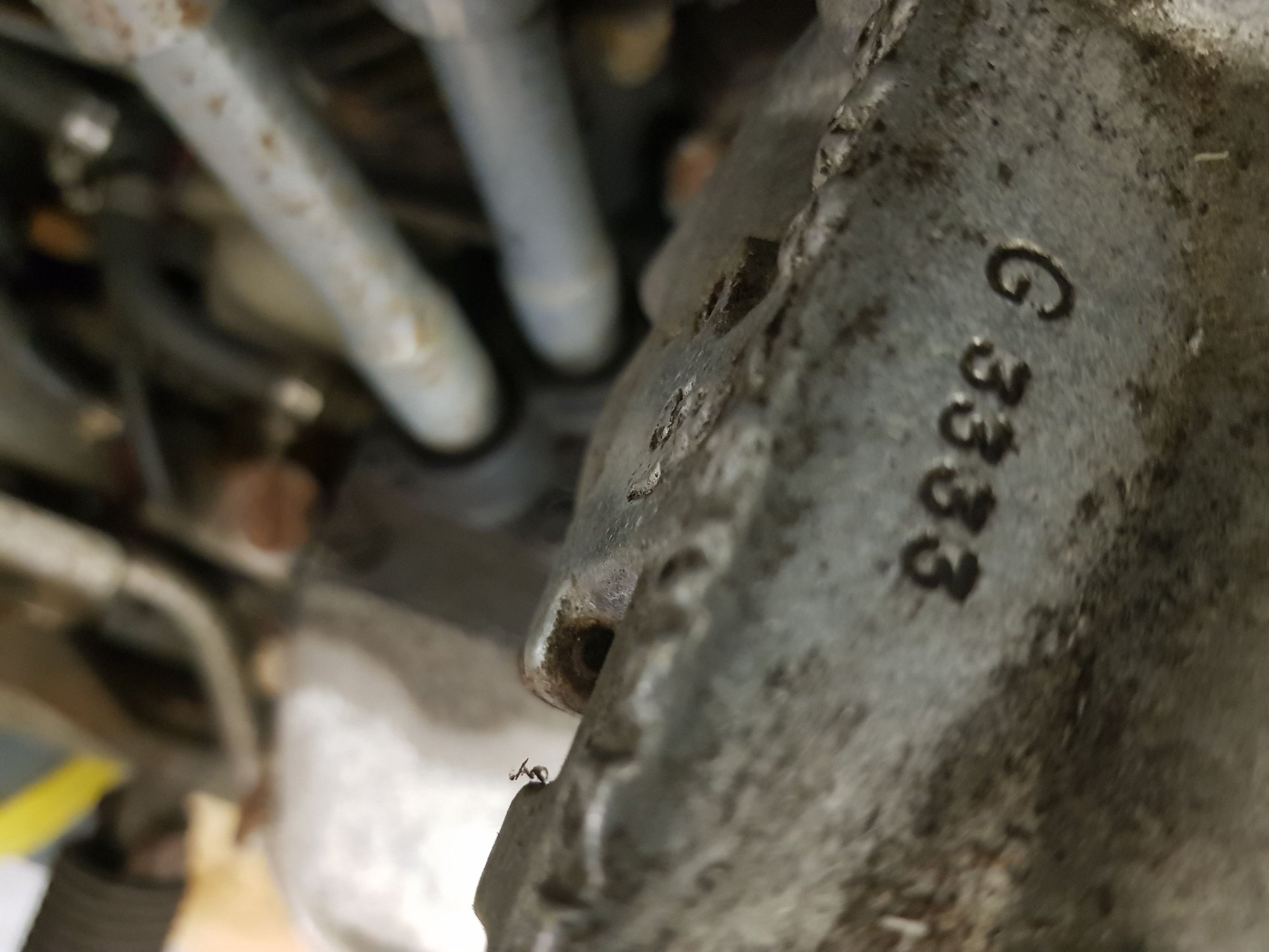

The VIN on the motor looks like it starts with 9D - that would indicate it was originally an FXE-1200. What happened in the last 45 years is anyone's guess. Does the frame VIN match?
ha ! Tks for that. I had been looking for the engine number ....
I assume frame number stamped / raised on head of frame ? Once I find I will be sure to advise.
Yes there is a 3/4x2" rectangular boss on the right side of the head forging where the number is stamped. It lines up with the downtube.
found. it is pretty hard to work out but appears to start with a 9H which matches with the FLH Police Special speedo

Re look at your pictures the 9D is plain to see on the engine dont know what the frame has you did not picture it

its a rainy day here in Sydney so good time to get bike on blocks , and start pulling apart.
Lazer focus on getting mtr running before attacking the other issues.
poor picture but this is the frame number ...... well at least you cab make out the "9"

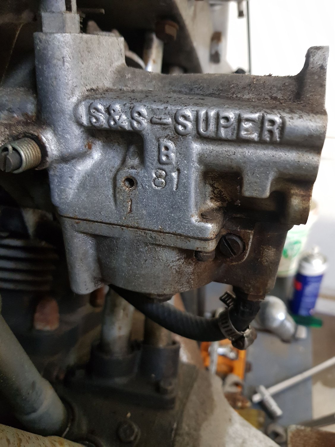

Carby details .... Any thoughts on this type ? I am planning to find a refurb kit for this.
As an aside , does the plug going into the rear cylinder come form the top hole . Neither were connected .

Old Jun 19, 2021 | 05:47 AM
johnjzjz's Avatar
johnjzjz
Posts: 12,878
Likes: 5,449
From: la la land jerzey
Its a dual fire system so plug location to coil with points does not matter
