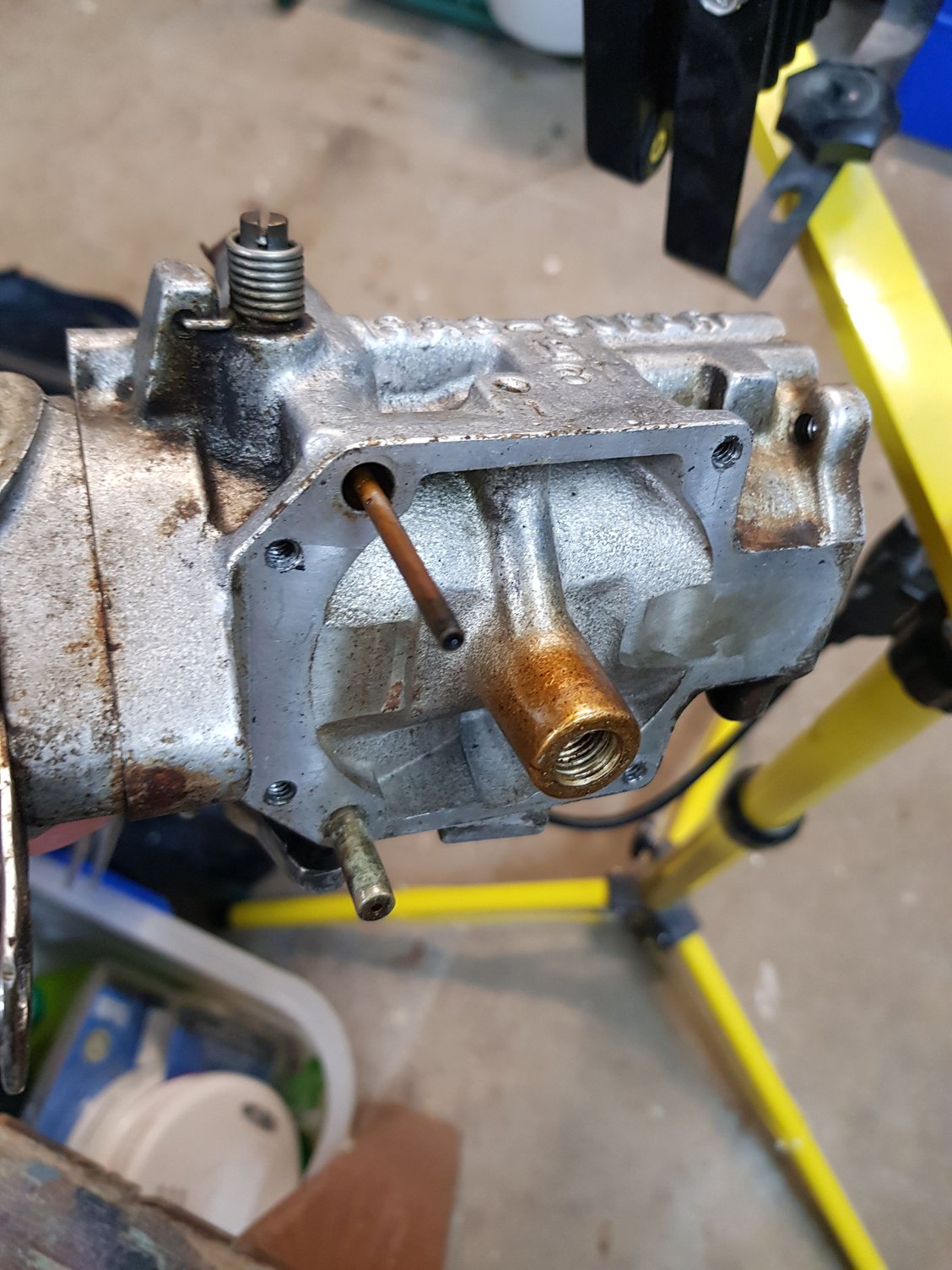

Just a shout out to get confirmation that the intermediate jet on the S&S super B is removed "forcibly" by pliers
TIA
Old Jun 19, 2021 | 08:58 PM
johnjzjz's Avatar
johnjzjz
Posts: 12,878
Likes: 5,449
From: la la land jerzey
Take the idle mixture screw out and spray penn oil in it over night - before you use vice grips on the low jet - giving it a rap with a small light hammer will help brake it loose

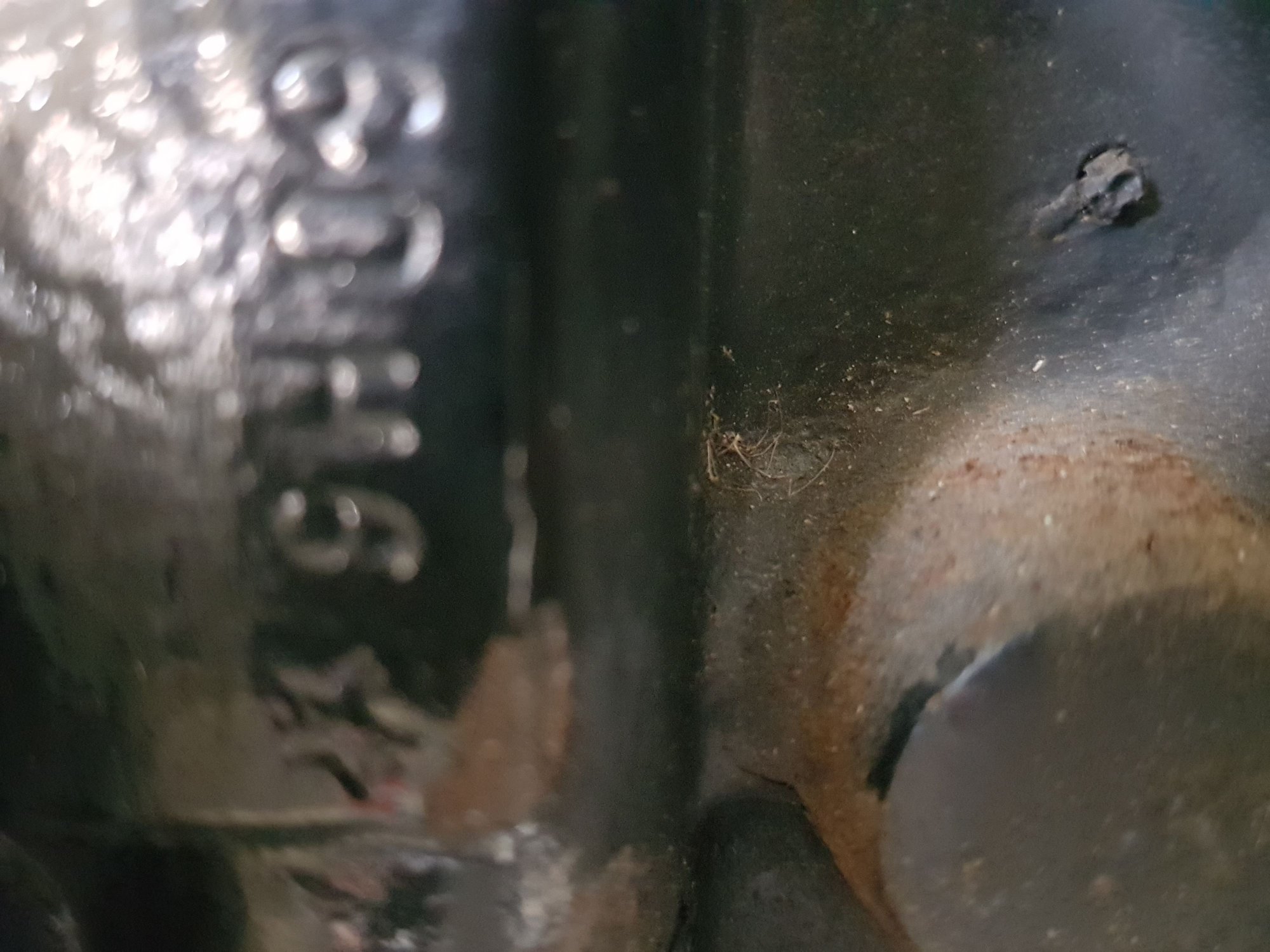

Originally Posted by w0m
poor picture but this is the frame number ...... well at least you cab make out the "9"
Welcome to the forum. I don’t see 9. Instead I see 6 (H6 for 1976). Which way are you reading the VIN? Normally it runs from top to bottom. Notice the 6 is a rounded character and the engine number appears to have the same type of 6. In the engine number notice the 9 is not rounded and you may find the same type of 9 at the beginning of the frame VIN.
Sometimes these two characters were interchanged at the factory but for 1976 (and certain other years and/or times) the factory seems to have been consistent regarding their application.

the intermediate jet is screwed in. sometimes vice grips are needed
Eric
I'm waiting to get the papers on the sale . Hopefully that will sort out the numbers. but thank you for info. Whilst the engine number is clear the frame is not , plus I have lousy eyes which doesn't help when I am trying to get best focus for picture.
thank you

Here’s a partial photo of a 76 Shovel frame VIN for comparison with some of your characters. From top to bottom it reads 9D+++++H6. Notice the 6 is rounded but the 9 isn’t. At least two types of D were used and this D is what I refer to as wide. The other D was narrower. Also used were two types of H and this H is what I refer to as narrow. The other H was wider but it’s hard to tell from your photo which type your frame has.
Earlier you mentioned 9H but I don’t think your frame VIN begins with that and there is more than one reason why. Anyway, once you clean the frame you may be able to read the characters more clearly.
At this stage your frame appears to be consistent with a 76 model. Look on the left side of its top engine mount and you may find a date code consisting of a letter and a number which will indicate the month and year it was made. The code may be up high or it could be lower down and near the hole for the mounting bolt.
Eric
