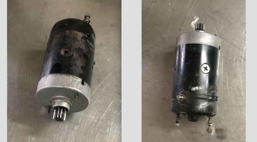

hello sbrmike,
heres a used OEM starter for sale in Germany for about 95 $ if you like i could talk to the seller for you if your interested . . .
used OEM starter . . . i could ask for more pic's if you like ? let me know !

Plenty of used starters in the USA for $8.25 (bought it) lots in the $29.00 - $35.00 range and new and used $85 and up. I am very rural. I may try to rebuild this one as well but it checks out with a shorted out Field. I haven't looked and the brushes, commutator or Armature. And I have another used one inbound for $23.00. I ought to be able to get one good one from the parts. I have brushes on the way as well.
The All ***** seems more trouble than it's worth. Like I said it is a very low compression internally stock engine. It has Points, S&S Super "E" and Drag Pipes with KW Powerplus baffles.
