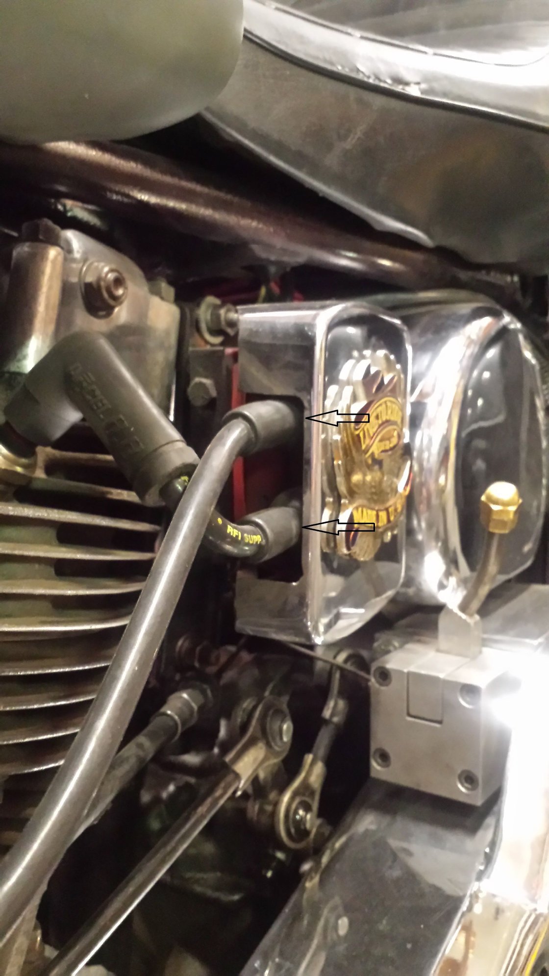

Here's a long shot. This actually happened to me a few years ago when I first got my bike.
Bike would idle fine and run good up to about 2000 rpm, then my front cylinder would start cutting out. Intermittent symptom. Drove me nuts! I finally figured out that the coil cover was vibrating enough that the sharp edge had cut thru the plug wires enough to short out. I learned what was going on while riding and reached down to make sure the plug wires were not loose on the coil. Got a nice jolt from the coil and looked down to see a spark jumping to the coil cover. Now that i think about it . . . this coincides with my need to replace the regulator. Sometimes I'm a slow learner. Anyway, I used my Dremel to take away some metal from the coil cover and haven't had that problem again.
