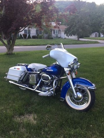

This was my 1976 i just sold it to a good friend month ago
