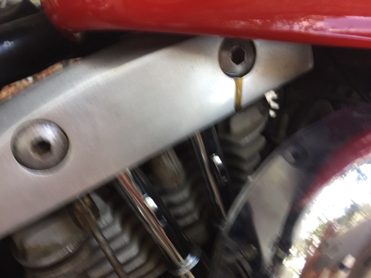

Hi, I have oil leaking from all of my rocker shafts in the covers.
Is it possible to change the 0-rings leaving the rocker covers in place?
If so any tips would be very much appreciated.
Thanks

Yes they can be replaced. I believe I used quad seals instead of o-rings. I’m sure someone will chime in on which one is correct or better.

Quad seals work very well. You may need another wrench holding the acorn not on the other side of the rocker box to remove the covers. It all depends on how long they have been on there. Some come right off, some are a struggle, good luck. Do not remove the rocker shaft, that will bring you much heart ache. Just remove the covers, clean everything up and install new quad seals.

I bought the below item for $7 on Amazon, solved my leaks. Search for the seller Mr. O-Ring
116 Silicone O-Ring, 70A Durometer, Red, 3/4" ID, 15/16" OD, 3/32" Width (Pack of 100)

In the shop we have relied on the nylon square seals to do the job and we do a coat of Yama bond 4 just because

Yep ... That's what I've used and quite successfully too

Thanks for the replies, I am relieved that the heads and rocker covers can stay in place to do the job. Will get onto it today.
