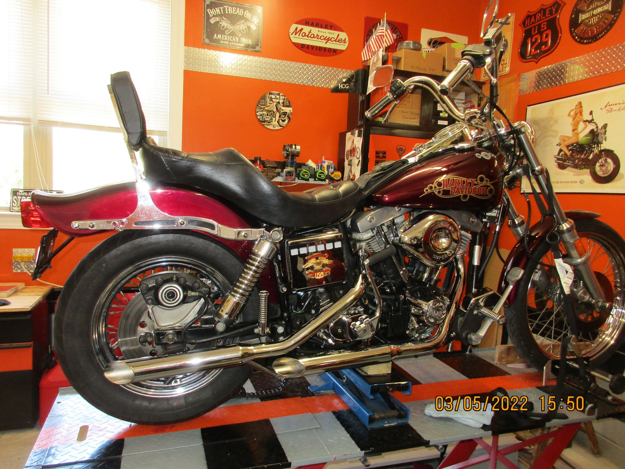

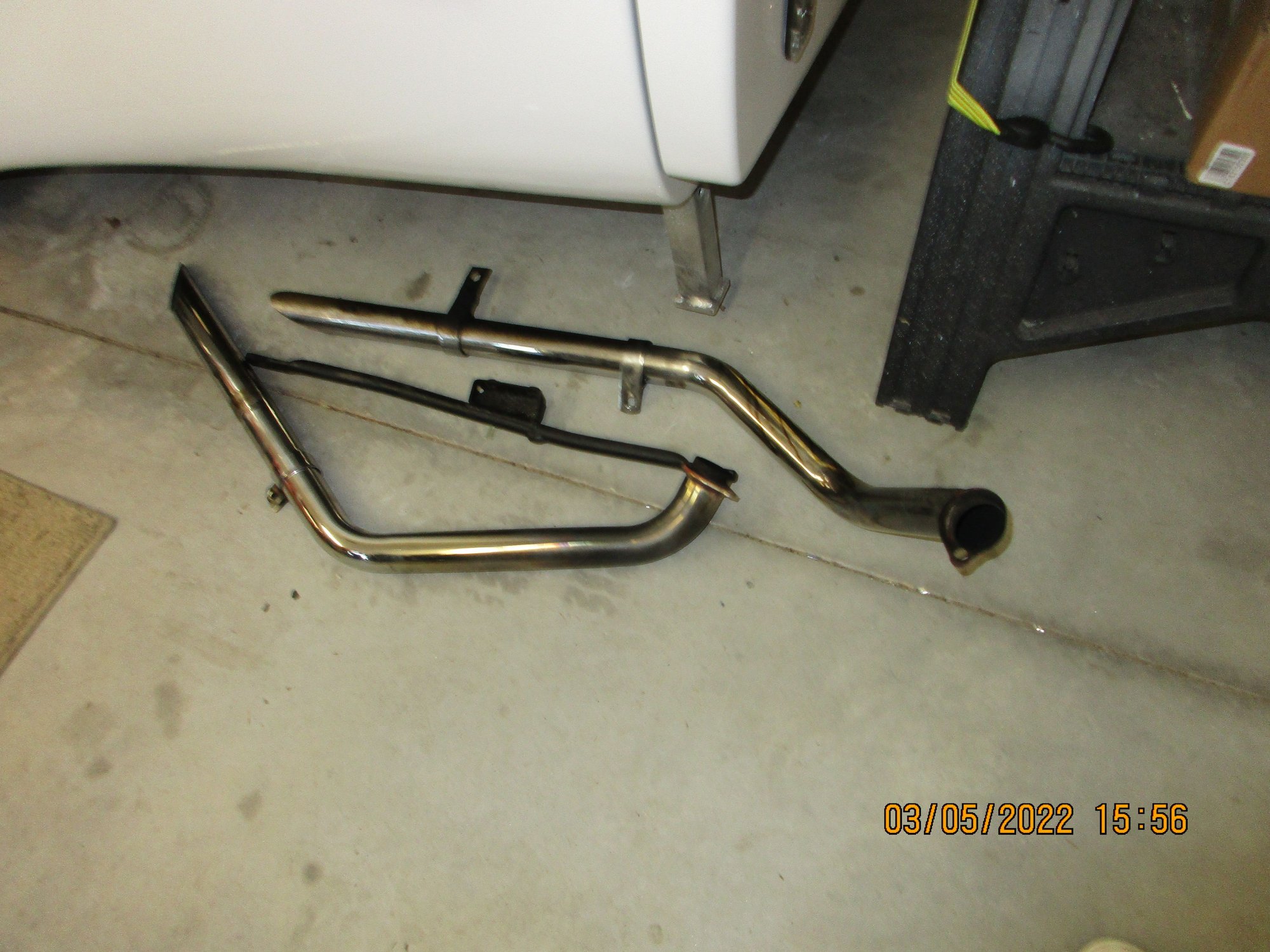

I lost the drag pipes on my FXWG
Here are the new pipes.
PO said intermediate jet had been changed for the drag pipes but he had no idea what the size so I pulled the carb. I found the main jet to be .068 which surprised me because the spark plugs indicated rich. The intermediate was .028.
I'm thinking the plugs may look rich because the PO didn't respect the enrichment lever.

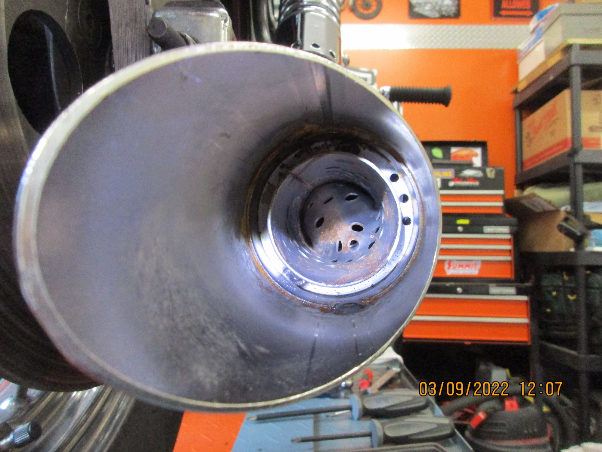

The new pipes are "slightly" baffled, no packing
What size jets do you recommend that I start with?

295 intermediate and 70 main is a good starting point.
