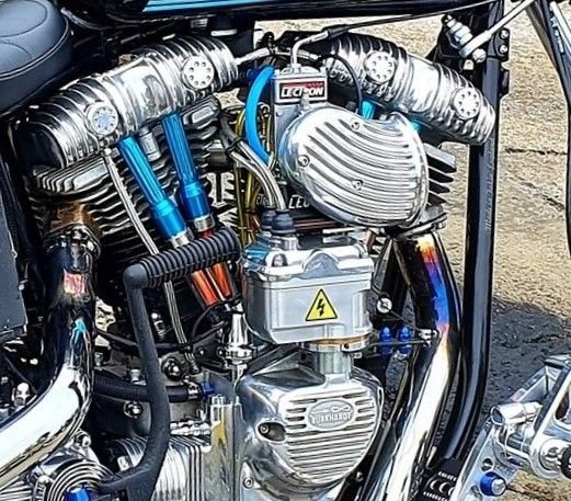

my buddy had a SB&FSportster lowrider that had a first generation Lectron & as you said it was pretty much a race carb & a very good one, the new 3rd generation ones have propper idle circuits & are as streetable as any carb out there plus a performance increse over the 1st gen ones as well, the tuning if any is needed for mixture is simply set by turning a metering rod in or out by micrometer Adjustment, but from the box, I didnt even need to adjust the idle & mixture is correct all through the range of throttle settings,...
yes, they are expensive, but really are worth it,
this is mine the very first run 3 years ago, my buddys riding it up to temp, then I was gonna set the idle, but when he remembered to retard the mag, it idled perfectly & hasn't needed any adjustments since fitted,...
