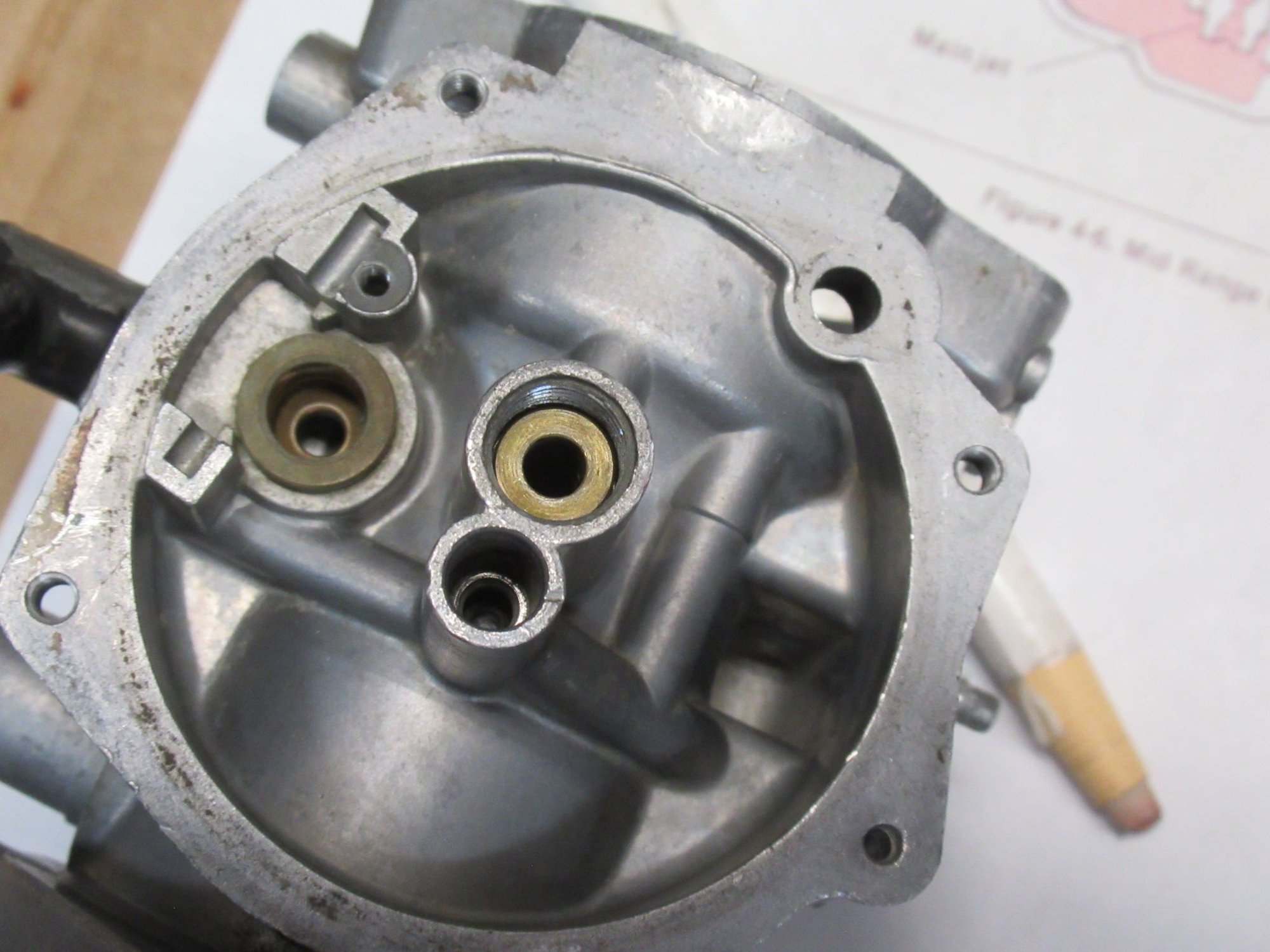

Today I assembled most of the carb. I didn't take many pictures though. One thing I wanted to document is cleaning up the float needle seat. I used a hard pencil eraser like a valve lapping tool and shined up the seating area. I also ordered a newer 4-sided needle which is supposed to be the best.

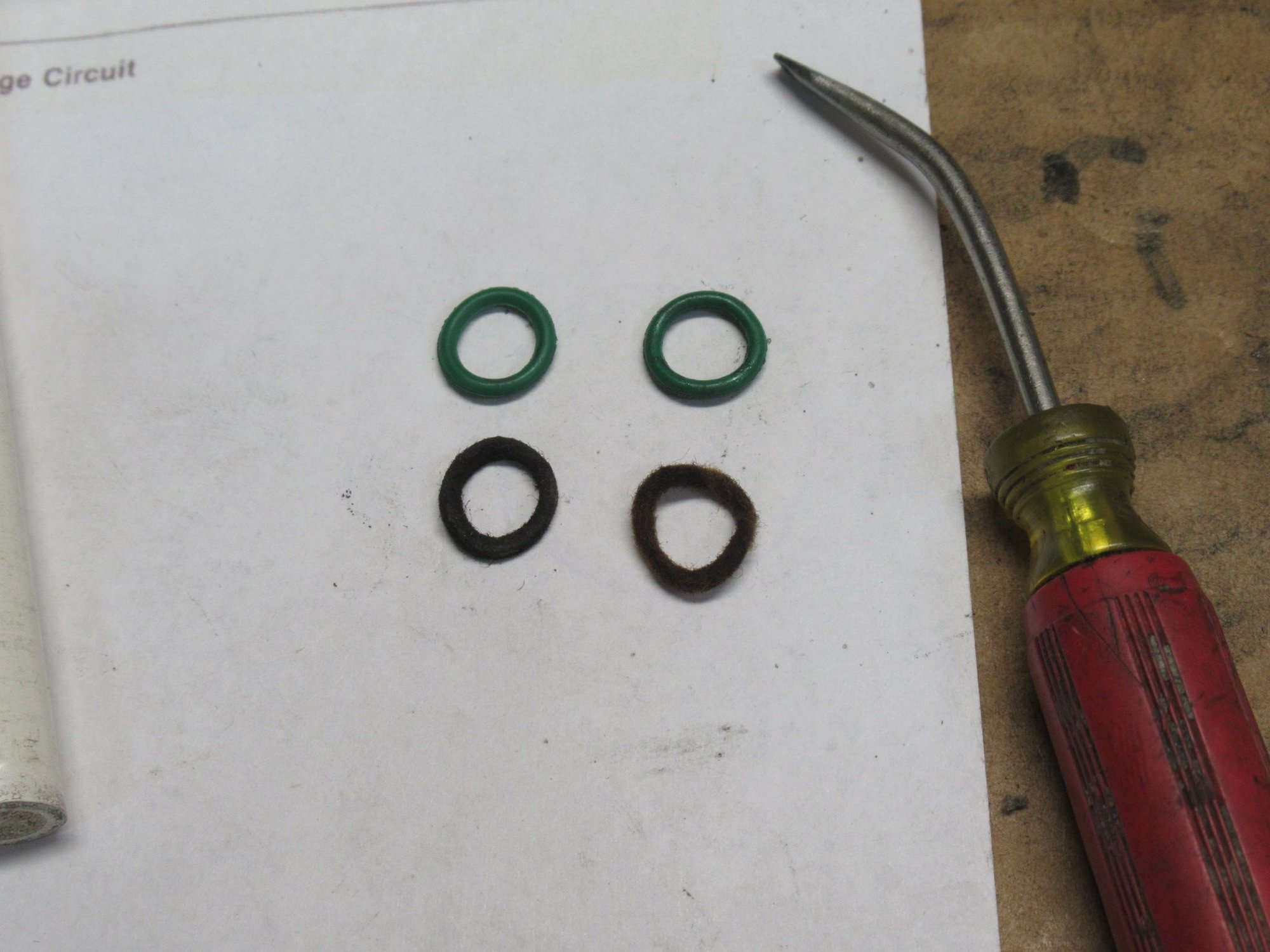

The throttle shaft has felt sealing rings in the body that I replaced with o-rings.

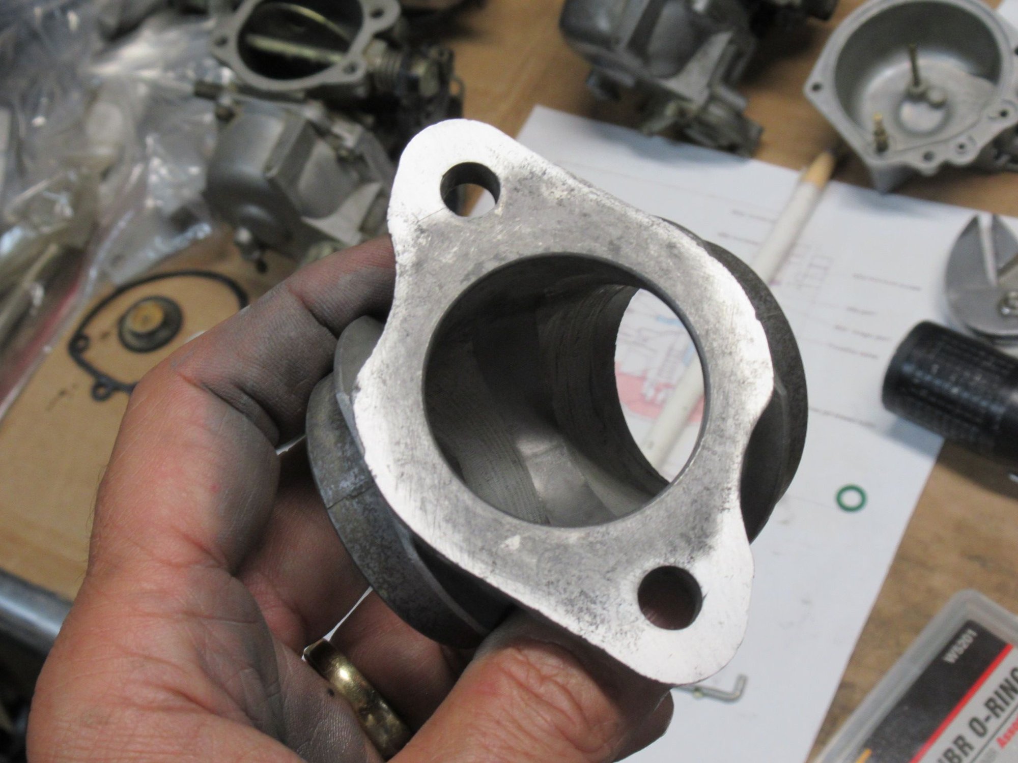

I sanded the carb and manifold mating surfaces with 320 grit paper on a piece of glass. Initial sanding shows how they warp over the years and need to be brought back to flat:
Here are the mostly finished products, waiting for the brass inlet valve and float needle. Not 100% perfect, but as close as I can get.
