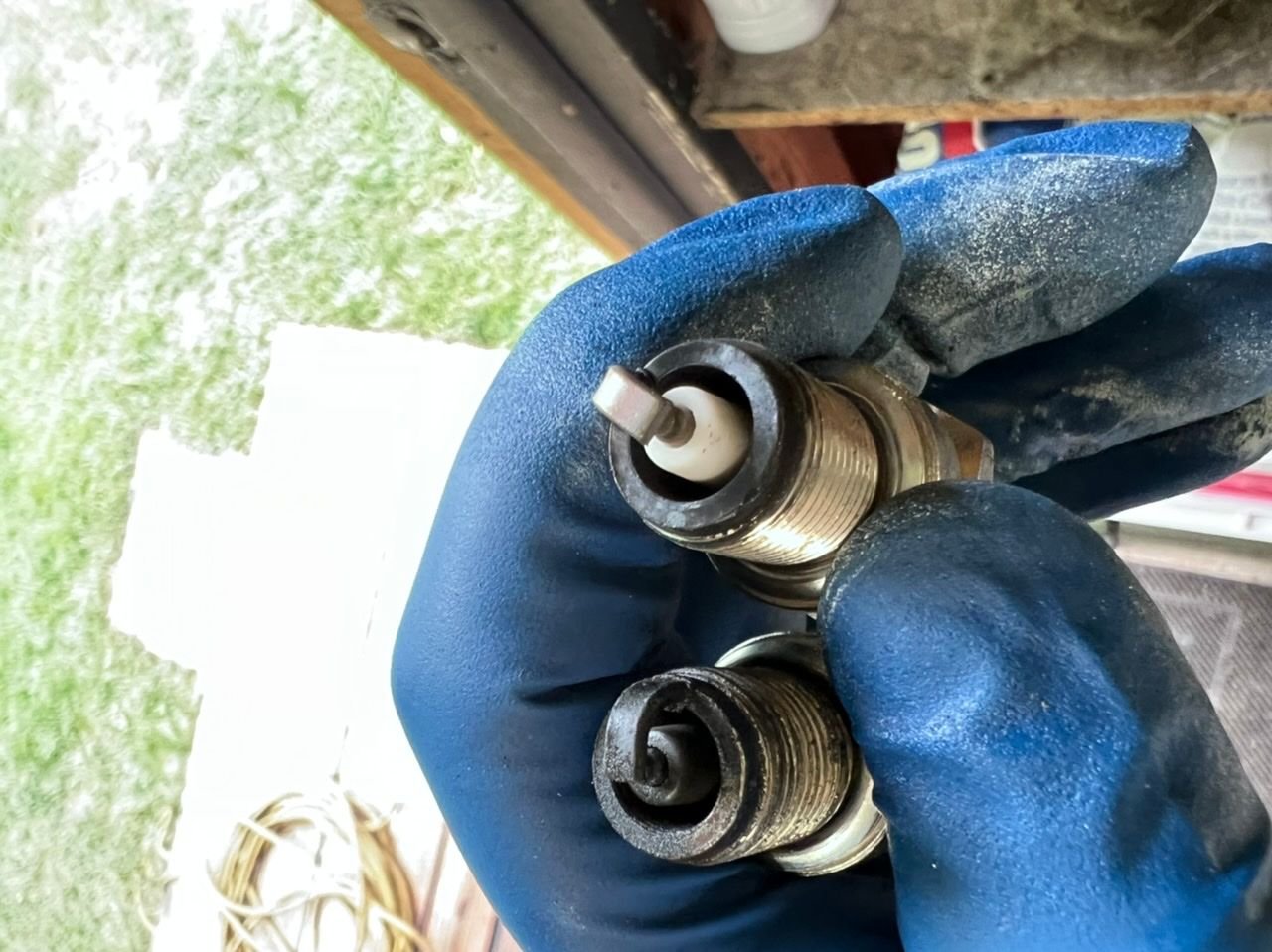

60-80 miles on these. Front cylinder is the dark one.

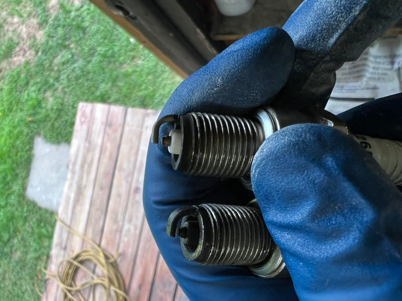

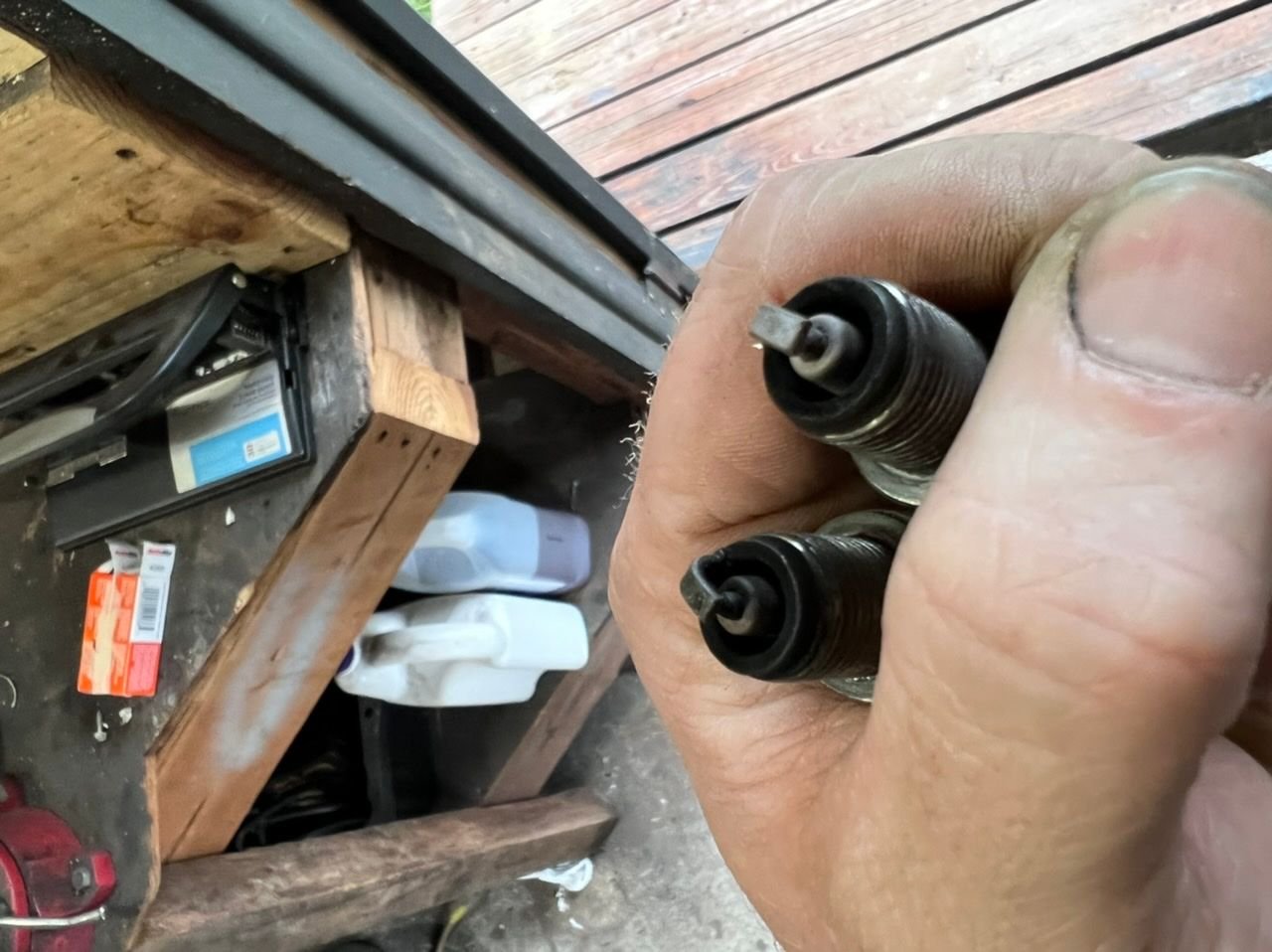

800+miles on these plugs. Front cylinder on the left.
