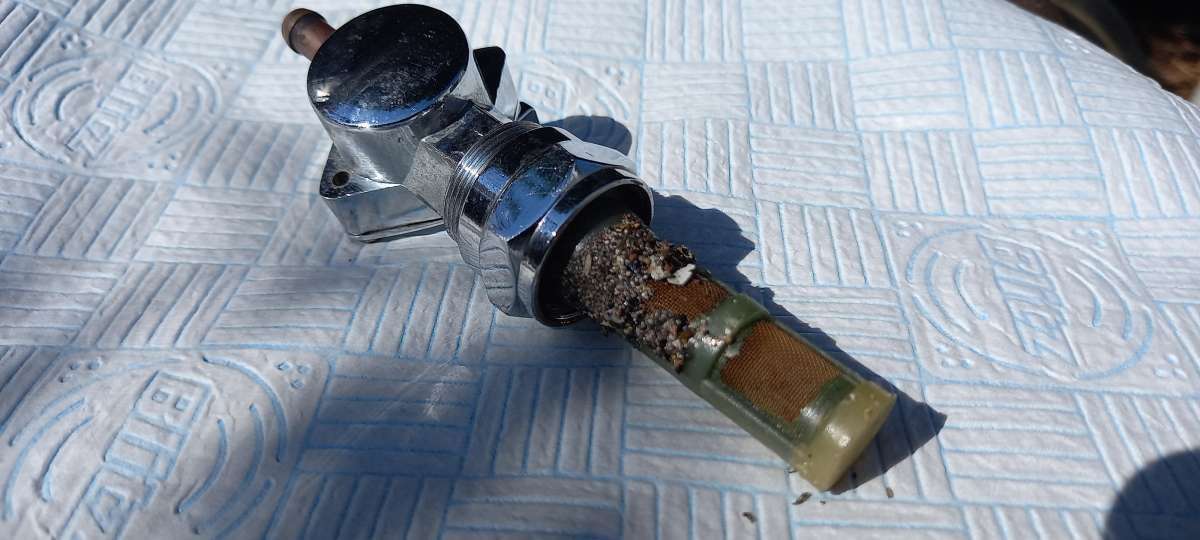

a shovel had your same problem

Tank and Fuel supply is fine I was not concerned with that.
