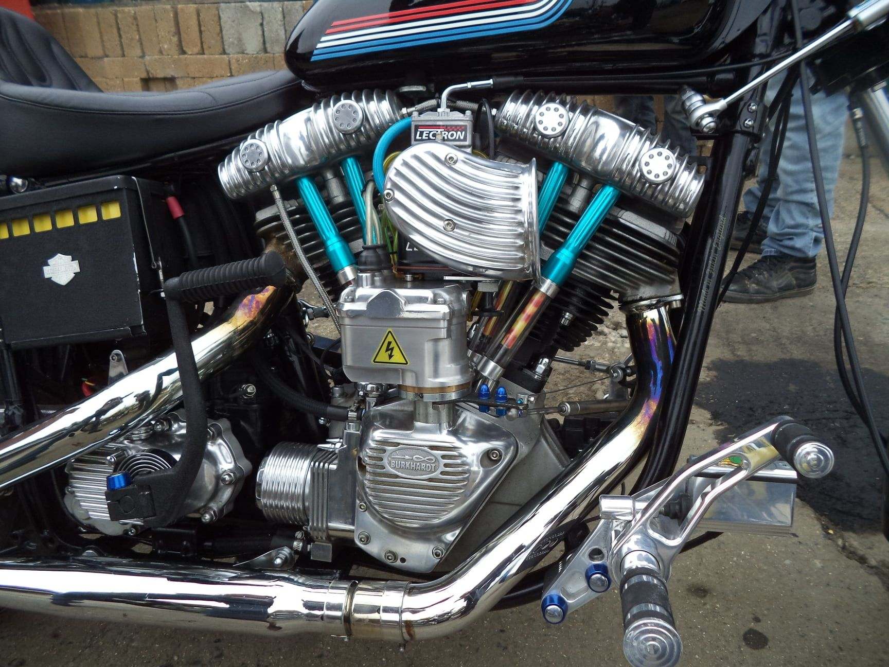

Anyone ever use this setup instead of stock oil pump? If so which setup would be easier?
The oil lines send and return would go on the bottom two holes. Any idea where I could put the pressure switch?

I have fitted a JBROSG oil pump filter end cover to my 78 shovel's S&S oil pump.....fitted great & a real easy install......, firstly they wont fit if your using mid controls, so if ya have mids, swap em out for forwards, otherwise they are great, VERY well made & designed......... direct feed with an easily spun on & off filter, I made a finned heat sink sleeve that slides over the filter to help cooling & for looks,
the feed & return I take underneath & find it cleans it up as you hardly see the oil lines,
the oil pressure switch I fitted on the top of the tappet feed screen hole on the top of the cases so no problems there.... all in all a great bit of kit to keep ya oil clean.
