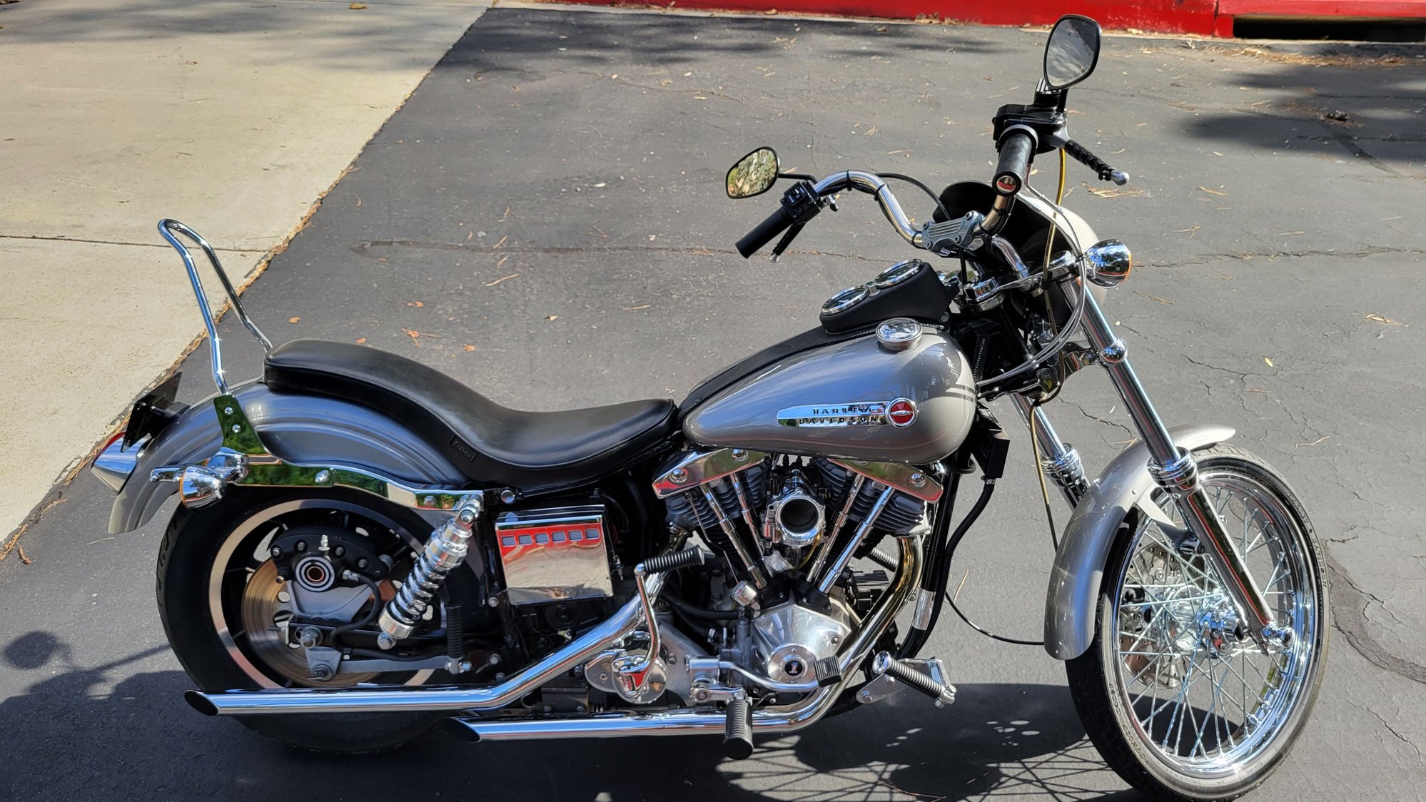

Default First Shovel
First shovel, arrived couple of hours ago.
1981 Super Glide
odo says something like 9k
A gentleman and his wife hauled it down from AZ in their travel trailer.
Thank you all for your help in choosing.
I like the way it rides and sounds . Have many questions.
Will post a video later.

Mentioned this in another thread, only thing you need is put the air cleaner back on and change the drags out to a set of Cycle Shack or Paughco tapered duals and just ride the crap out that bike as it is, think you'll find it'll grow on you qiuck.
You want the air cleaner to protect the engine and the pipes will give you much better a low end power band and torque, drags look and sound good but a shovel loses low end and has flat spots with them.

Nice bike. Congratulations.

I like the bike, but those early 70's style buckhorn bars wouldn't work for me. But it's not my bike so party on .....

Looks like a great find. I wouldn't change a thing yet besides
1. getting an air filter on there asap.
2. Check all fluids, tires, wiring that you can see, give it a good once over checking bolts and for anything out of place
3. Get a Factory Service Manual and a Factory Parts Book
Doesn't take long to warm up. Start it up, make sure nothing is puking, burning or making obvious mechanical failure noises. Once the rocker boxes get warm to the touch go out for a gentle ride for a few miles before winding her good thru the gears (and dont be afraid to wind it out.... NEVER lug the engine!).
Get some miles down. Try and get her up on the interstate for a bit too to see what the "sweet spot" is for your particular bike (no two Shovels are the same even with the same gearing)..... for some it's 60, 65, or 70 etc.... you will know what the "sweet spot is when you are in 4th gear and the bike is humming along at its smoothest. This speed/rpm is a good thing to know for your particular bike.
Take note of how it runs/rides/stops... take note of clutch action. If it's a good one (which it appears to be)... there won't be any major surprises on your first good ride.
After some miles you should do a more thorough inspection. Checking for leaks, any other issues that may pop up after your ride etc.
Once you get even more comfortable with the bike then it's a great time to really look at things like what ignition does it have, popping the spark plugs to have a look at its state of tune, opening up the pushrod tube covers to see whether you have solids or hydraulics, seeing wiring integrity more thoroughly (popping the headlight out and taking a look inside the bucket, taking a look at the wiring under the seat). Getting to know the bike more... learning its quirks, the "sweet spot" etc.
Everyone here will have an opinion on this/that when it comes to things like bars, seats, pipes, forks, controls etc etc etc.... those things are all subjective because those are items that are "beauty in the eye of the beholder".

Don't choke it with a little clown filter, the classic teardrop S&S for that carb will only add to that bike looks wise.
Suspect that bike a decent runner, add to that with whatever you do.

Beautiful, clean FX.......you did good!!!
K&N has a good filter for the S&S teardrop.
I would lose the half/*** fairing.
