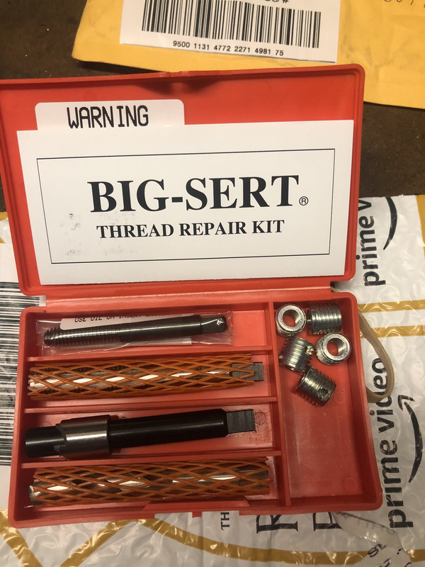

Here is the Big Sert kit which I can also use but I will try redoing a helicoil first, followed by a step stud if that doesn't work. Both seem less invasive and less work than using a Big Sert:

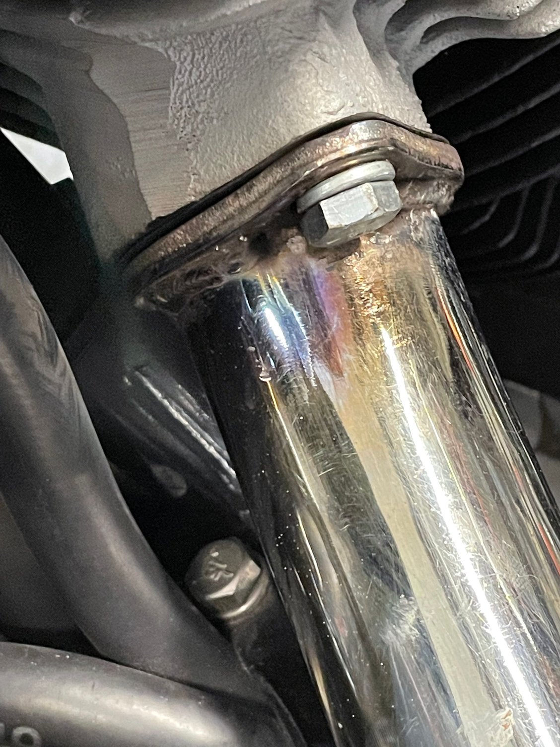

Here is what I am dealing with. You can faintly see part of the heli coil exposed. It is slowly pulling out. Periodically.... i have to tighten up the Stage 8 bolt because the heli coil has slowly pulled itself out causing exhaust leaks. It aint the bolt that is loosening up (it cant due to the Stage 8 design) but the heli coil. Nice and tight cold, engine heats up and the helicoil gets loose. Most likely I will have to go with the step stud....

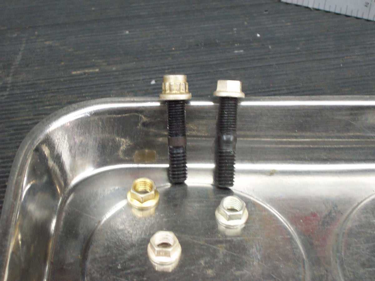

I use the stubs in conjunction with surplus aircraft grade 6 or 12 point flanged nuts, silver plated stainless. That and a bit of Permatex ultra gray all my shovel exhaust port stupid has gone away..
Love these flange nuts, use a 3/8" wrench, zero clearance problems with them and they do not back off like regular hardware. Ebay or some online surplus hardware places or a local aircraft surplus yard you find around small airports.

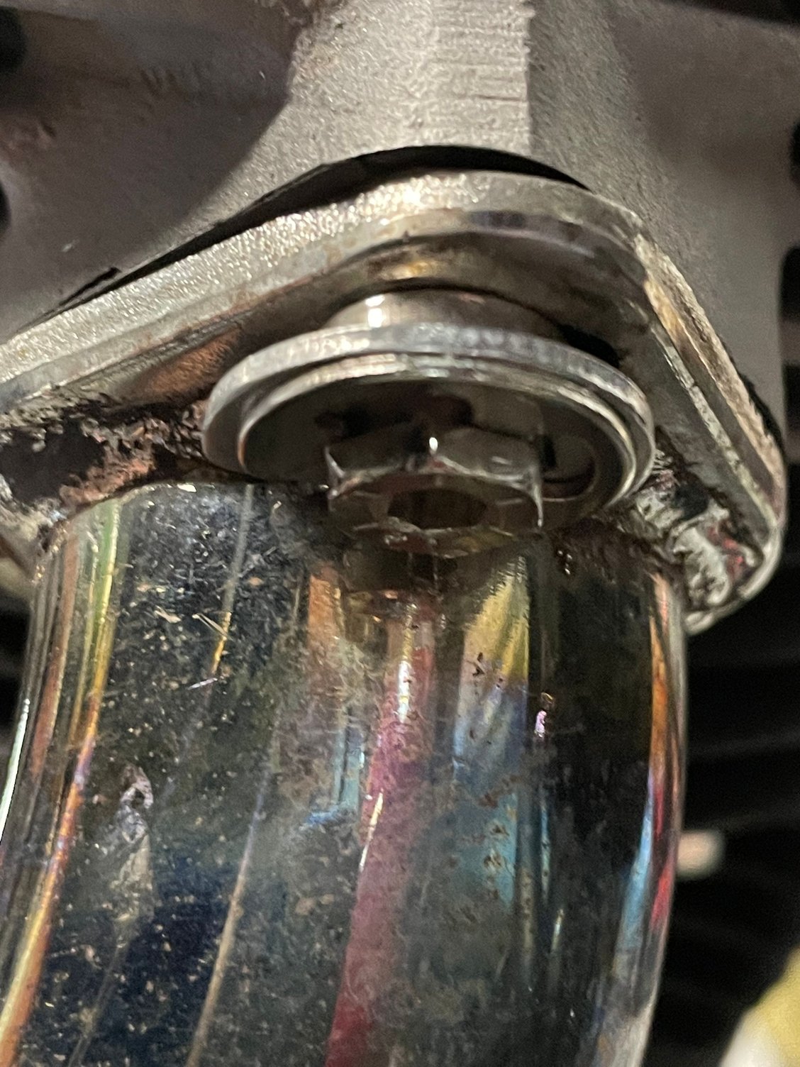

I’m hoping this stud fix it my last. Less stress in the head threads too. My biggest ongoing issue with my mild stroker is the exhaust bolts backing out. It has a lot of power / pressure pulsing so it’s way more problematic than my last shovel. The backing off has been directly related to how much throttle - juice I’m using. My front is getting blow by and isn’t really squared up - pipe flange to head port, even when it hasn’t seemed to back off. So here comes the stud…
This is working. Fortunately the head threads are good - stock. I had to go to this when the $42 lock kit kept having off. The rear was the worst offender. Do far good. This shovel has way more power than my last.

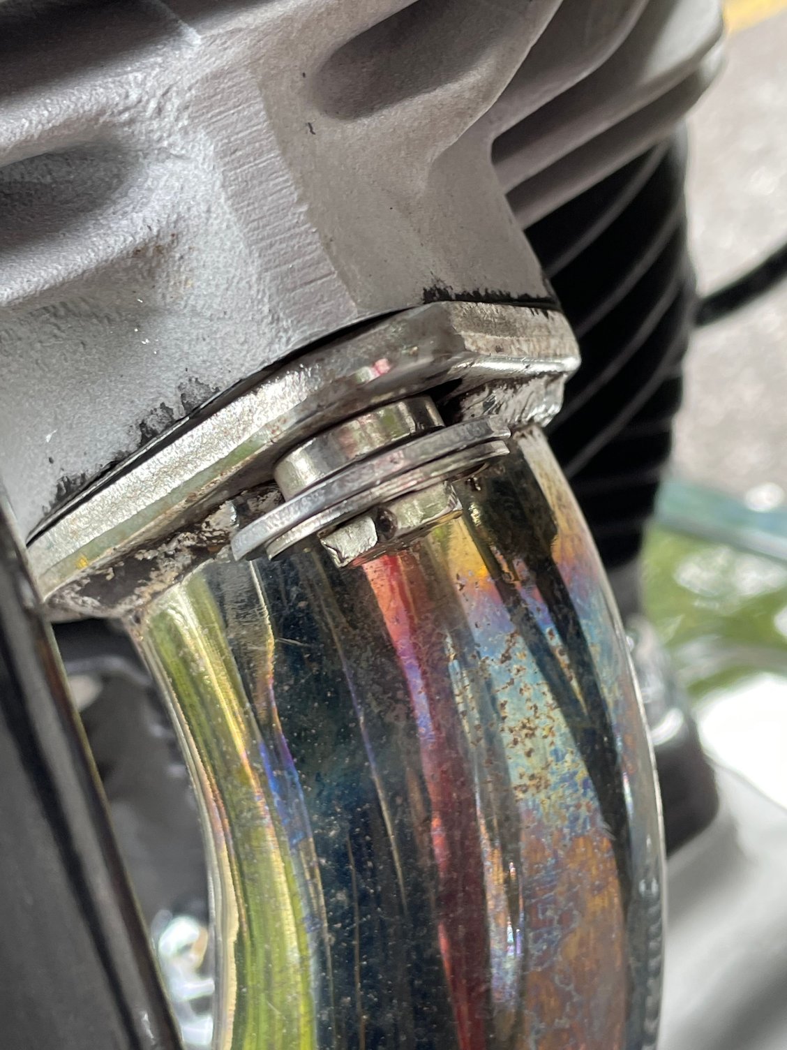

Replacing this with the stud set up. I already lost the rear. Blew away on my way to the AMCA meet 7/31.
Same front, to be replaced with the stud setup like my rear.

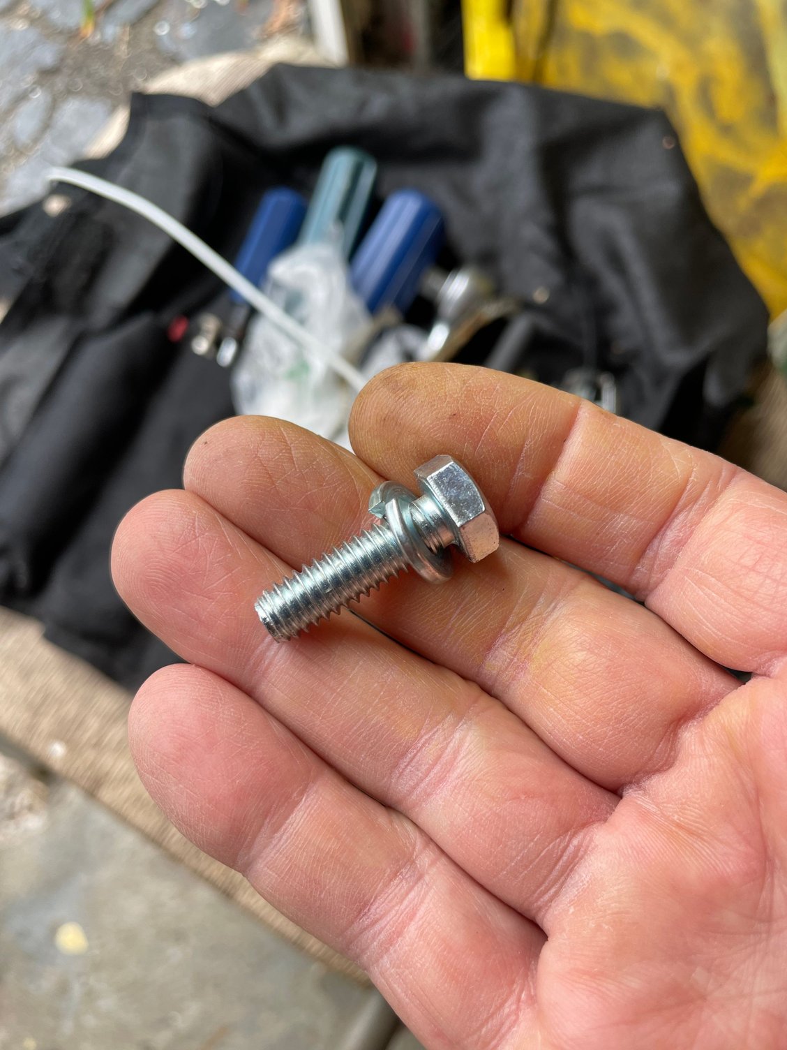

This got me home when I lost the rear “lock kit” on that Sunday. Found an open hardware store in a small town. I Keep a couple in my kit.
