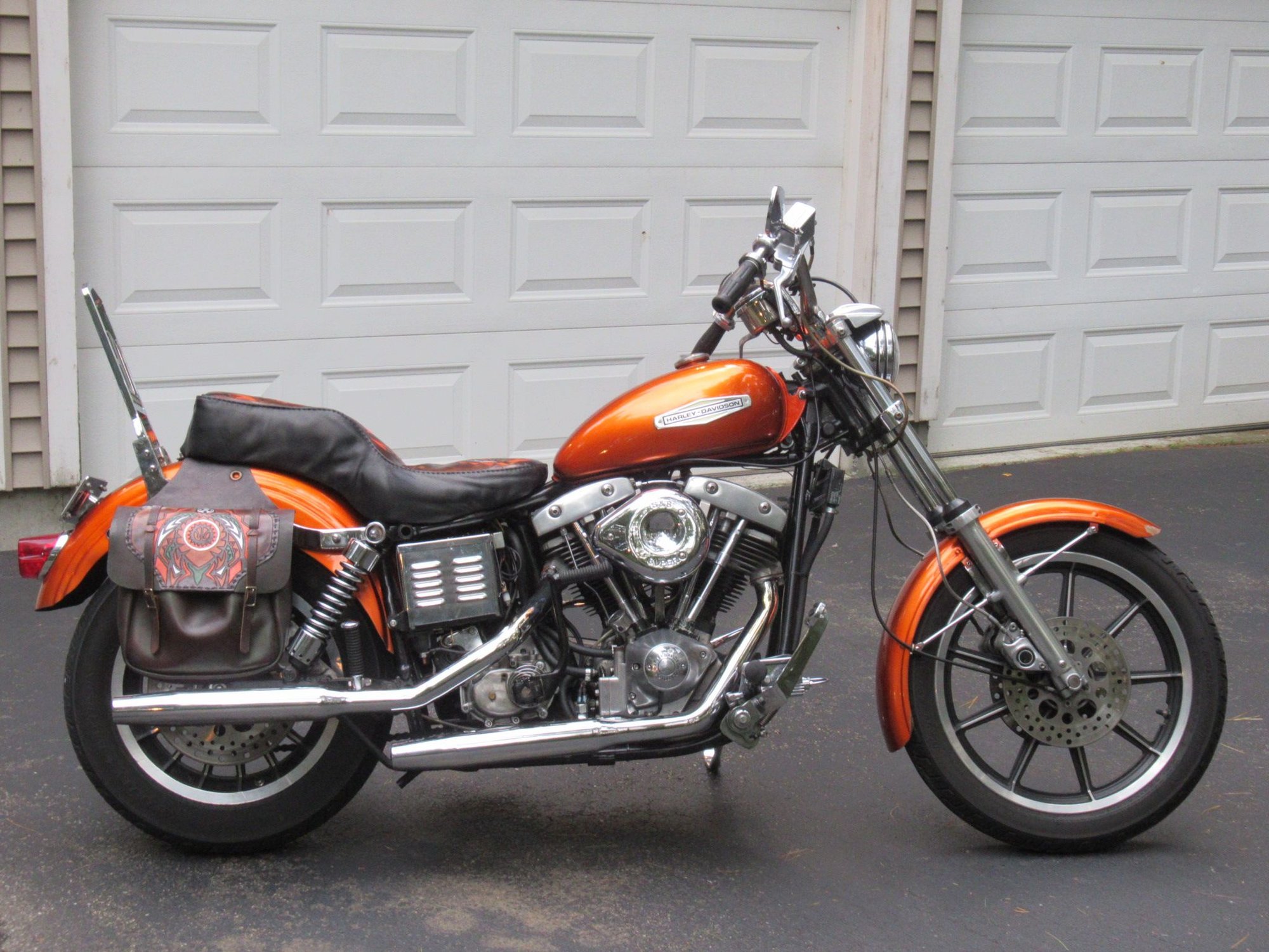

FXS had 2" longer forks than FXE, looks perfect to my eyes.
+6 is chopper territory, +4, IDK
Old Nov 6, 2022 | 06:34 PM
NO_SPRK's Avatar
NO_SPRK
Joined: Aug 2016
Posts: 303
Likes: 37
From: Santa Rosa, Ca
is yours +2? I want +2 atleast. I should put a 2x4 under my front tire and see how it looks. I'm ok with the way it is now but it's annoying how the front muffler scrapes on corners
Originally Posted by Joe12RK
FXS had 2' longer forks than FXE, looks perfect to my eyes. +6 is chopper territory, +4, IDK
Old Nov 6, 2022 | 06:40 PM
Joe12RK's Avatar
Joe12RK
Joined: Jun 2012
Posts: 6,154
Likes: 2,560
From: CT/FL
Yes that's +2 of a stock FX
