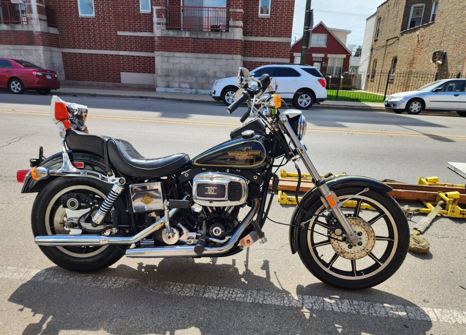

He told me that he did not like another shipper because they pulled the forks down all the way and blew the seals, so I went with Keyboard like he recommended. He also sent me this video. Sean has been a very trust worthy seller to me so far.

Beautiful bike 👍. Nice find.
I'd have no problem with how it's tied down.
The lower triple tree is fine to use as long as you only partially compress the forks and use tie downs that have hooks with spring loaded gates that will keep them from bouncing loose.
I also like how their rack allows them to run a strap through the back wheel and pulls down and forward.
