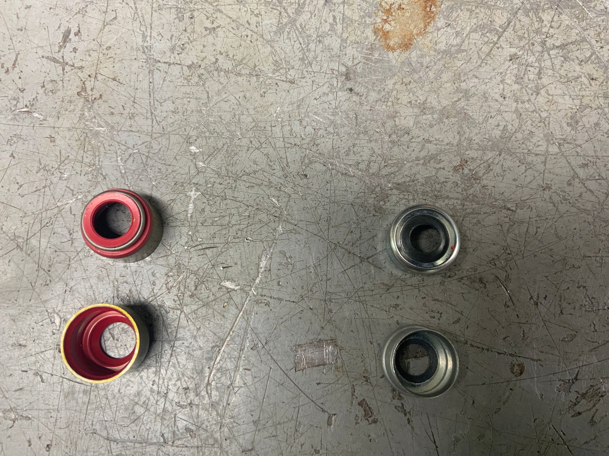

dont 1/2 a$$ it you might have a worn valve guide causing this it will at some point wreck the valve seat hitting it at a odd angle that it normally does not
and replace the rocker bushings - mike the shafts to ensure they are round and not worn also - ball hone it and re ring it with moly top rings and the valve guide seals must be the rubber ones not tin china junk see below

That's a hard must do for a shovel for me, be surprised the noise level drop when done right.
we torque them to a number and stay on that torque or the distance changes the last time doing it a drop of blue is insurance
