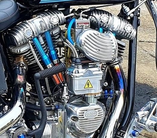

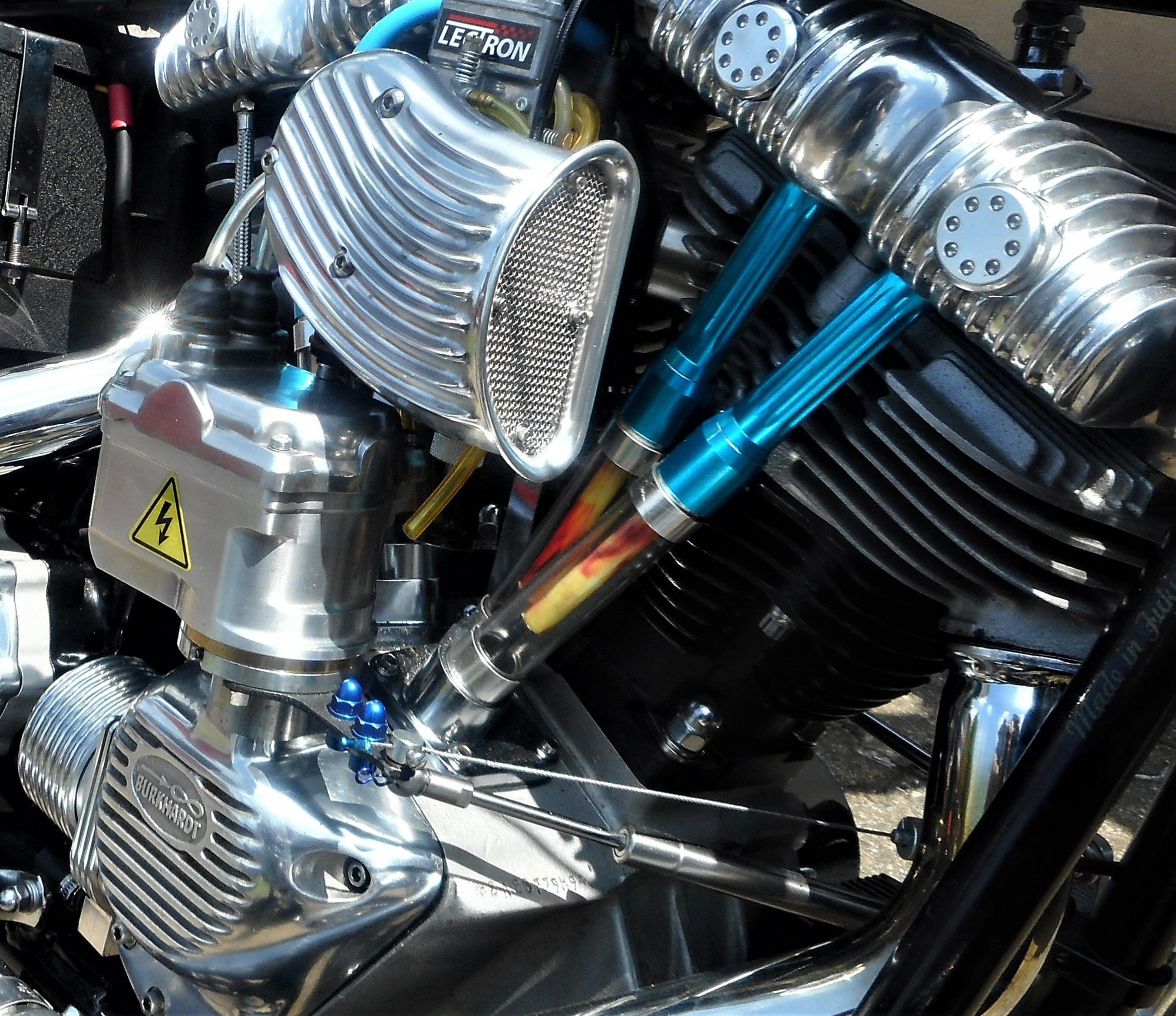

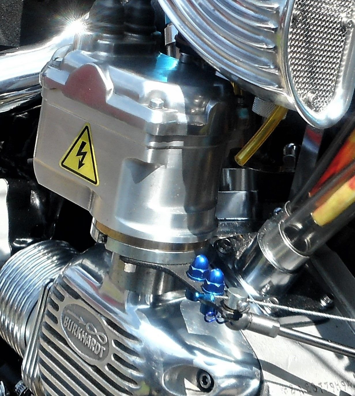

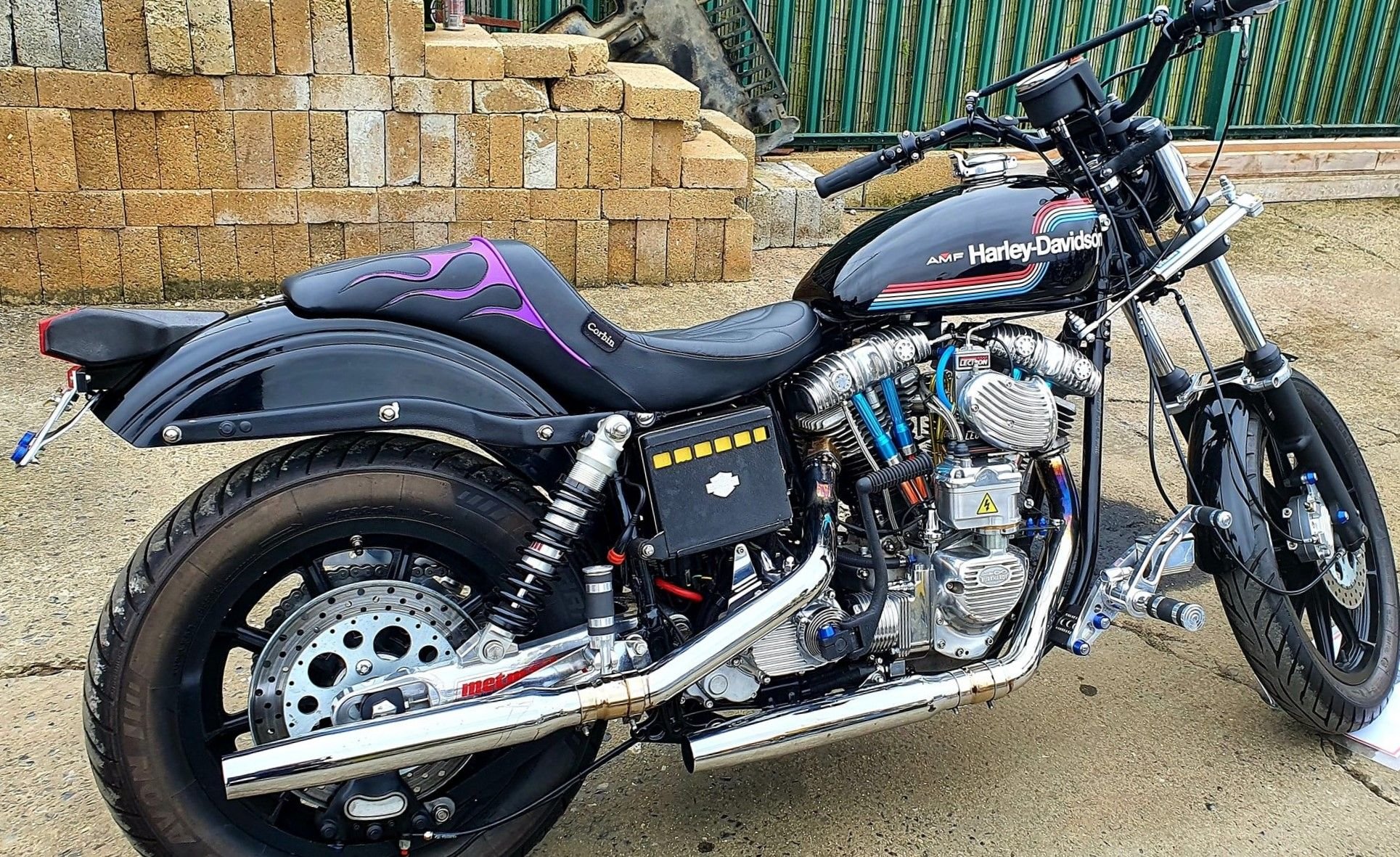

this is my 78 Shovelhead, with Morris rare earth magnet Magneto on a burkheart cone (sadly a repop by V-Twin, needed a LOT of work to fit and work, had i known it was by tiawanted i would have avoided it, but got it good in he end)
i have a cable advancce /retard lever on the bars from an old Brit bike, with a Nitrogen filled strut to ai retarding when the levers pulled back at idle,
works great

wow that's a sick shovel dude.

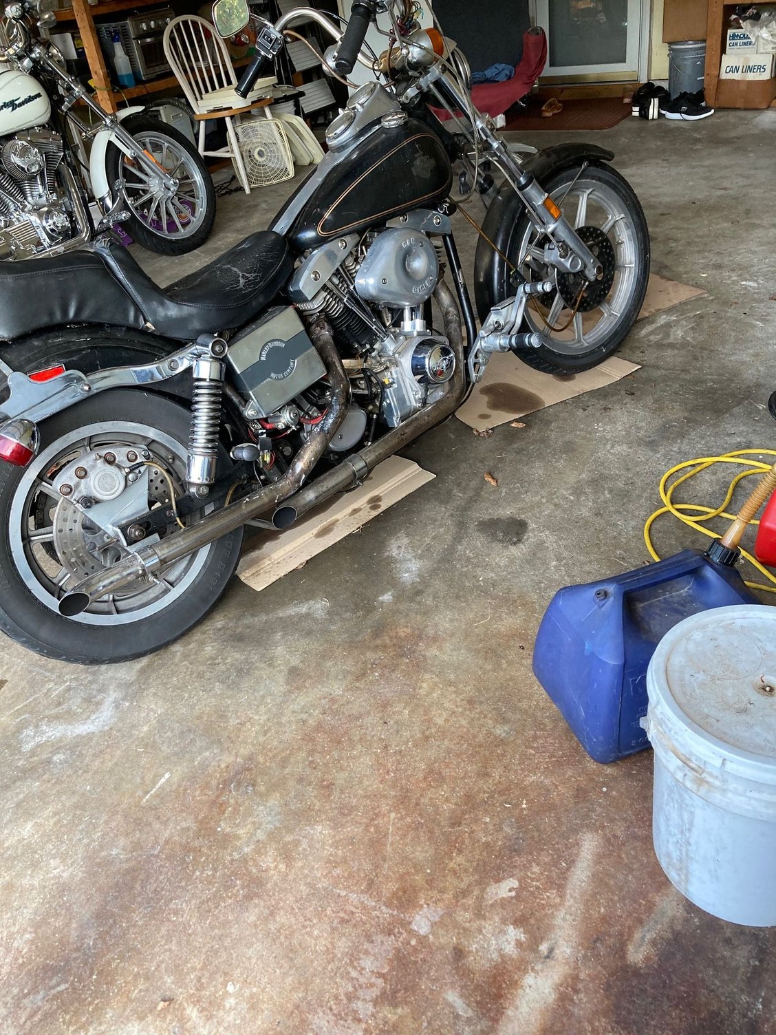

hey homey mine different from stock have forward controls. but here it is drill couple of outside clamps and you're home free.
