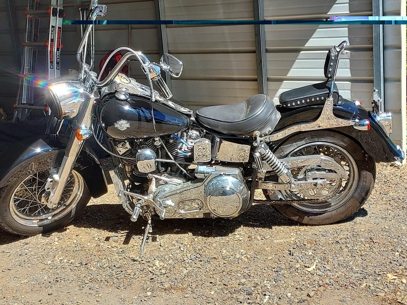

Don't be in a hurry, deals are out there, I just picked this up very reasonable, builders title but it's all there, decent quality stuff and legal. Going to go over it, make sure it's solid and clean, and she'll be up for sale.
Wise words indeed....I never leave my bikes totally stock, but I usually buy them that way and with a title because no matter what else happens, you still have a bike you can legally ride.

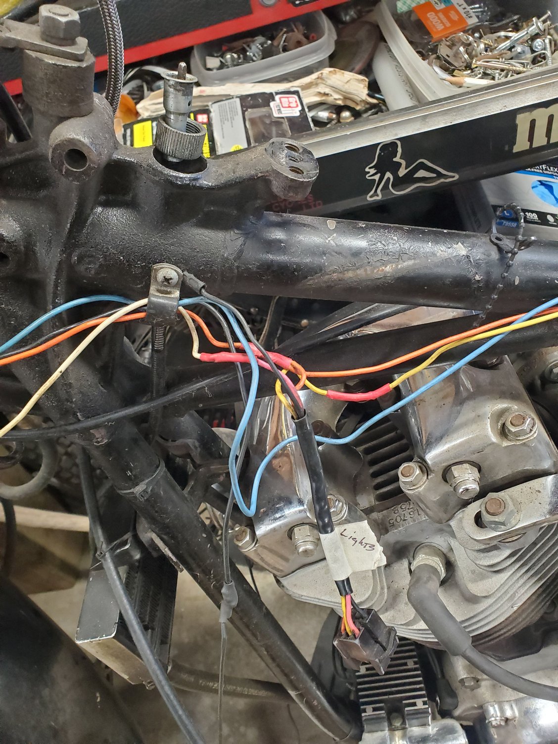

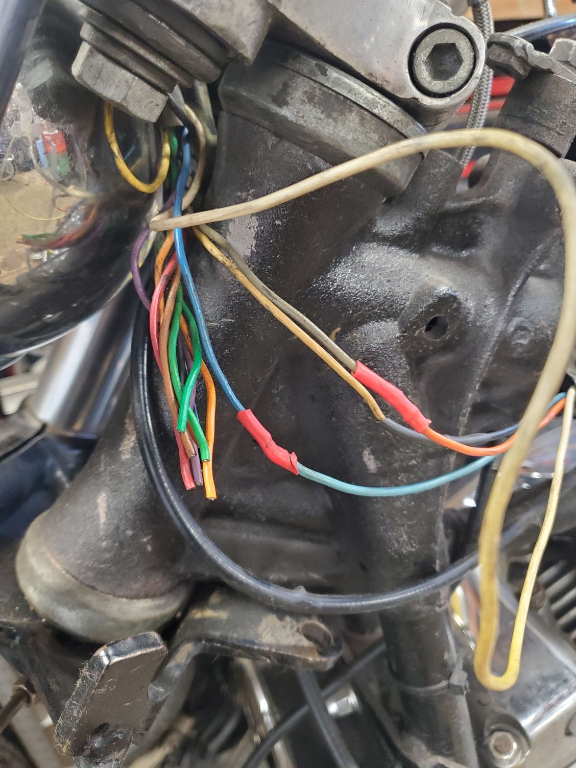

Update on my wiring debacle. Started tracing wires and thought I had a good handle bar set up.
Found no continuity from switch to exposed wire at seat post. Hmmm.
I cut the cover off the harness and found the left and right harnesses cut at steering neck. Just cut , not removed.
I was thinking to get extended handle bar harnesses to give the length between the tank and replace switches at the same time.
