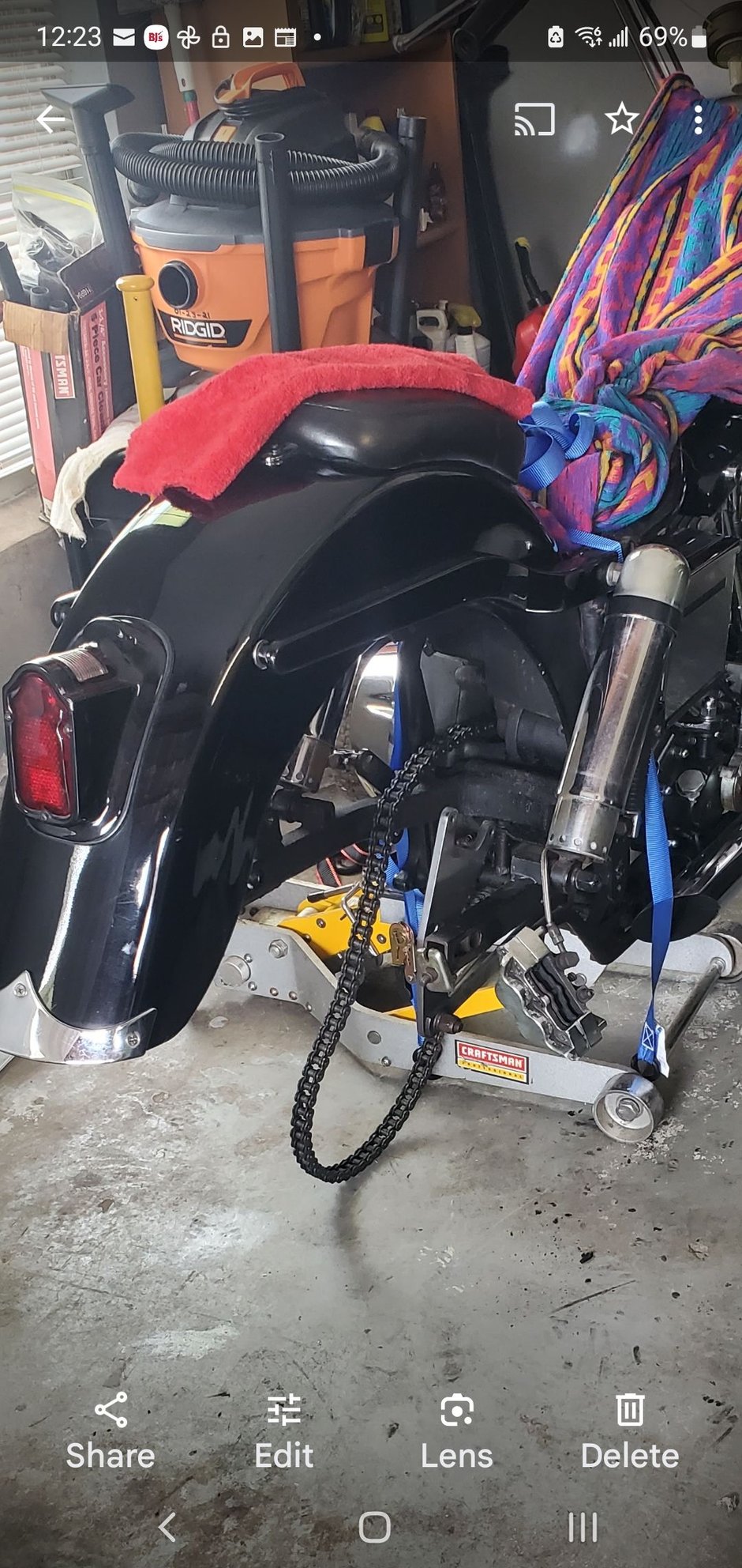

I've just got new tires for my 81shovelhead.
Front went back on yesterday.
But before I put rear back on is there anything I should be checking?
It's a greasy mess in there so I'm gonna clean up swingarm, chain and surrounding areas.
Can swingarm be lubed without removal?
Just wanted to check before I slap it all together again..
Tx!

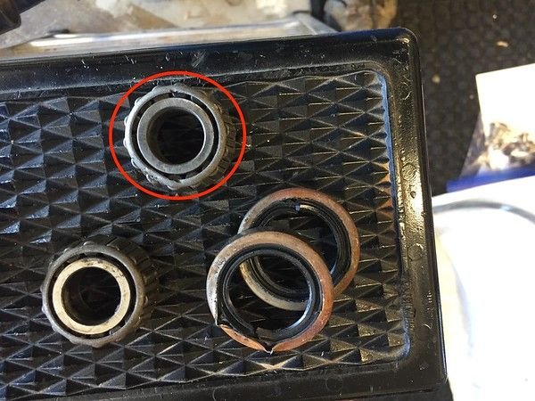

Pull the swingarm bolt don't be surprised if it's grooved where the bearing rides on the chain side, you run a finger across and feel it, replace it, Impacts the feel and handling of the bike far more than you know.
