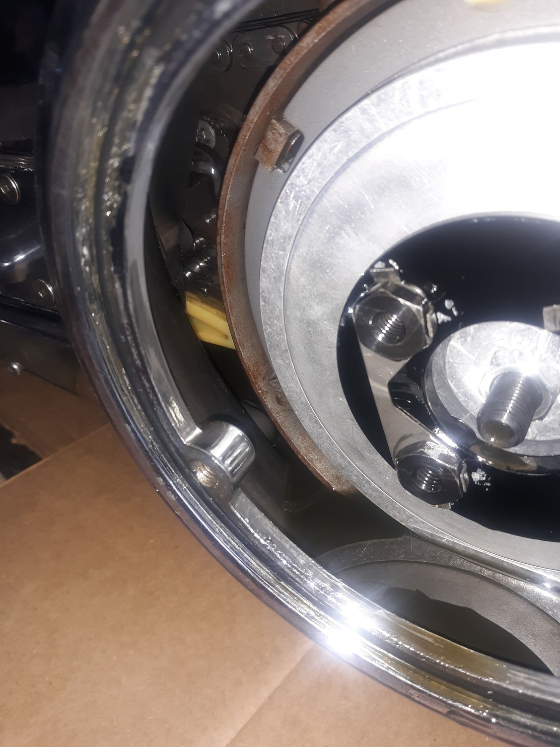

Originally Posted by tld6008
Way too much oil, original system dripped oil onto chain and what accumulated in primary was continually scavenged back to tank so very little was actually in the primary at one time.
Ok, I'm trying to learn. With it being sealed now, would you say I should take inspection cover off and just make sure the bottom of chain is covered?

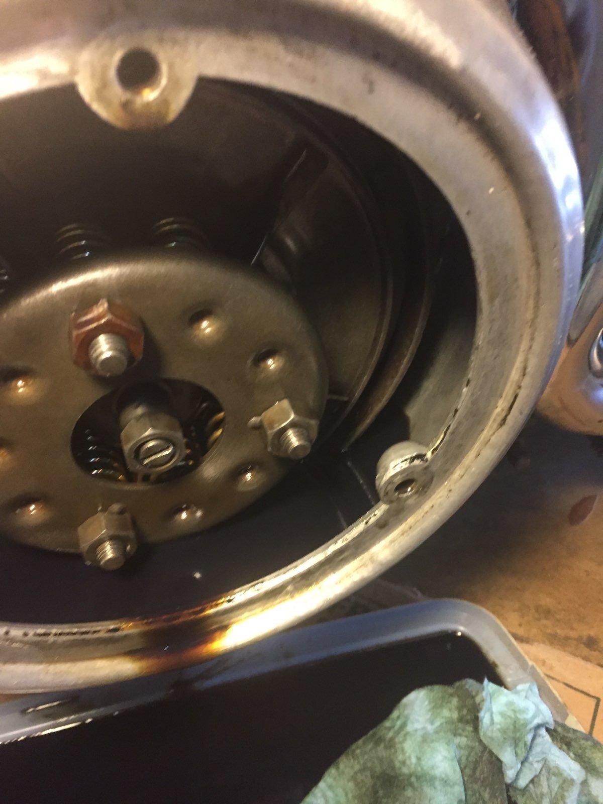

Originally Posted by bulldog1776
ok I think I understand now. I can look down through the derby cover with a flashlight to where those teeth are.
Thanks
Here is mine with the bike NOT upright
No Way I run nearly that much..contaminated Clutch Plates. Again...the Shovelhead clutch is Dry!! If contaminated the Best that happens is Slipping, Ther Worst..and most cxommon..Lurching, dragging , generally Grabby!!!
There is another Great reason I am Against Isolating!!!! The Second is that the primary needs to be sealed up anyway... for stock system to function!

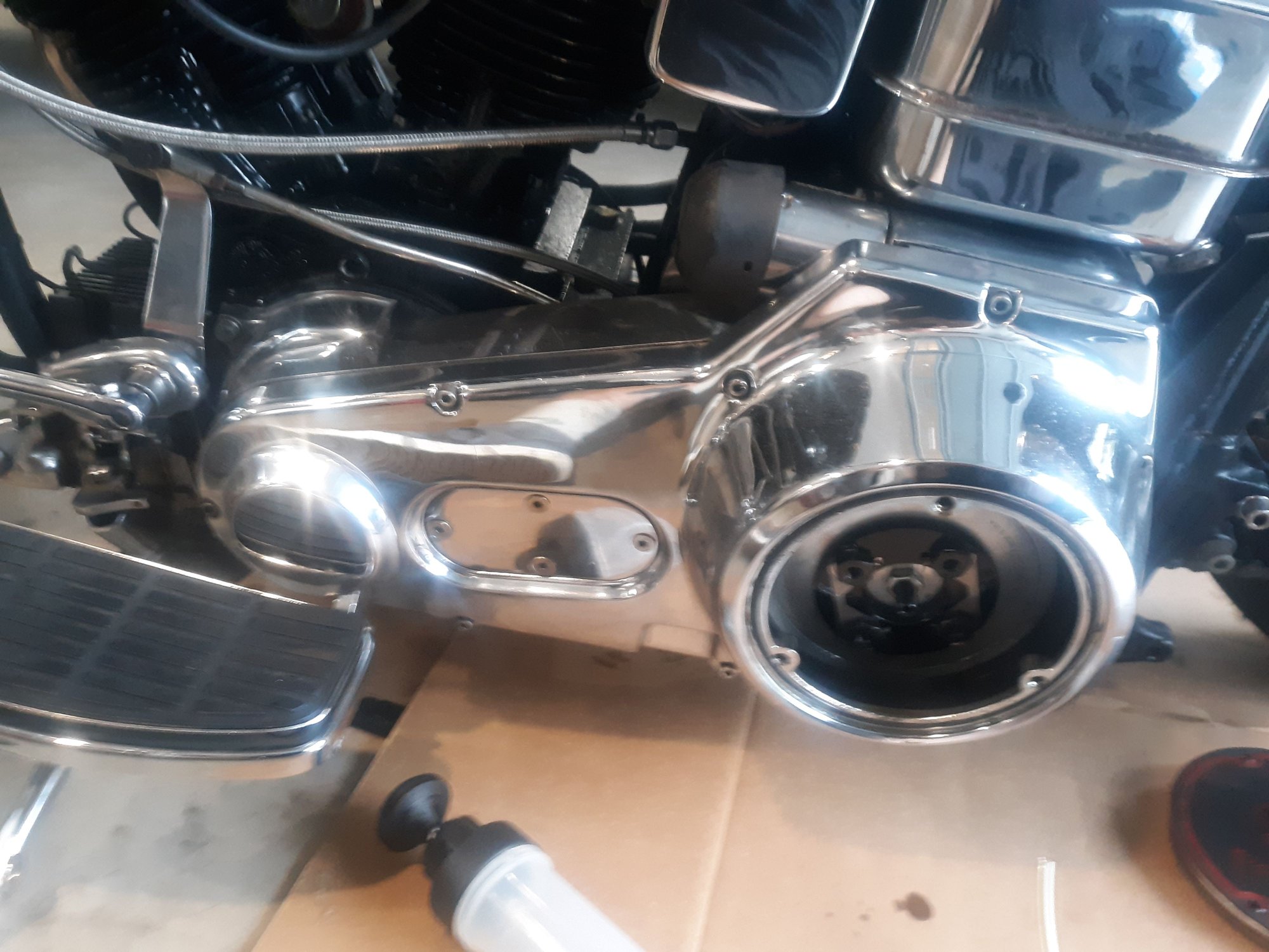

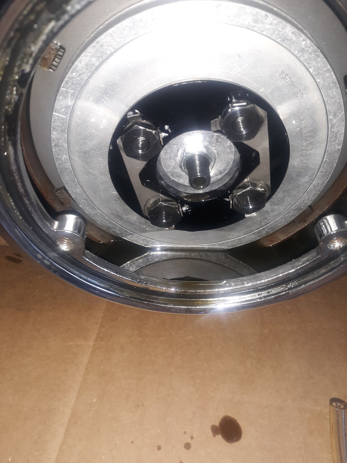

Thanks guys. I just took some fluid out.
Here's some new pics this time on the side stand.
With this being isolated is this enough to keep my primary chain ok?
