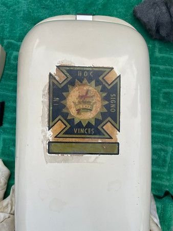

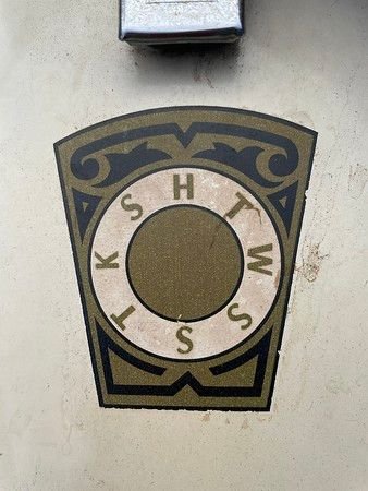

Originally Posted by johnjzjz
I see communist $hit on top of the bag lids they must have come from Canada - ya no frozen brains and all
Knights Templar and Free Mason I was told
