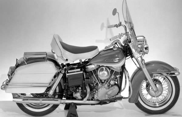

Pic is from the 1972 Accessory Catalog. Doesn't have a lot of info and it it is really short on details (only 12 pages total, skimpy compared to other years of HD catalogs)
Front and rear bumpers were pretty much standard issue equipment, but here is a factory photo of your basic, bares bones 65 FLH model. HD offered several "levels" of factory enhancement packages for a modest price increases for the different levels.

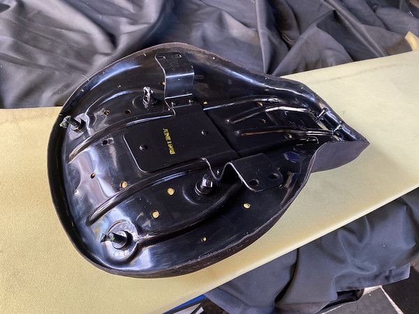

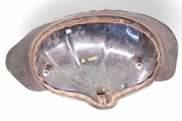

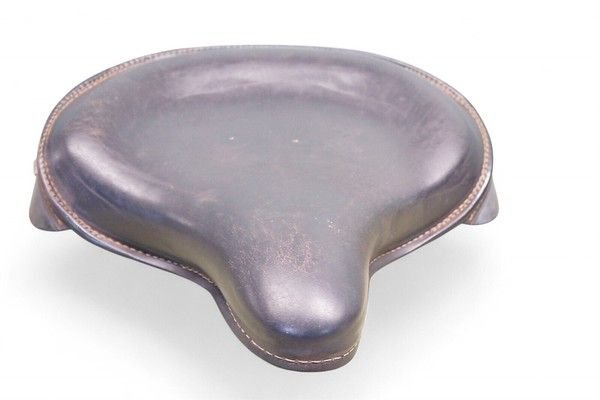

Understand you are wanting a police style solo seat (I have done the same). It looks as tho your seat is correct for your year (seat patterns changed a bit over the years) and the backrests are definitely factory options. Might look on the bottom of your seat. Should be a yellowed date stamp on it that will look something like this
AMF years solo seat also had a date stamp on them and the leather underside that was riveted was brown and not black like all current aftermarket and even HD ones sold today.

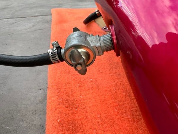

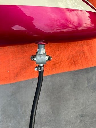

Parts books only lists this type of gas tank for 66 and up FLH models and this type of petcock (until 1974).

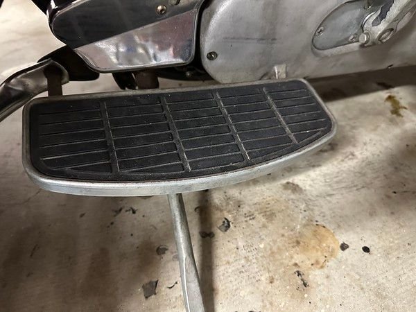

Your floorboards were first introduced for 1974 models and in the accessory catalog are referred to as "Shock-Proof Floorboards" (#50603-74). Here is a pic of the floorboards used from 1966 to 1973 Big twin models:
I cannot tell from looking at yours just how thick the rubber pad is, but on mine (67 FLH), it is very thin, even thinner than the cloth=backed pads used on my 65 FLH. And don't know what holds the rubber underneath to the metal boards, but mine is flat and the metal at one time would have been cad finished.

6. I wish my fuel tank was the correct year with the correct petcock....but its not. It is either a later model year Harley, or aftermarket, fuel tank, and the paint is very nice, so this is one I will concede on.
7. The floorboards on the bike are the cushion style, and I will replace them with correct style as in your pictures.....hopefully cad plated, and not chrome.
