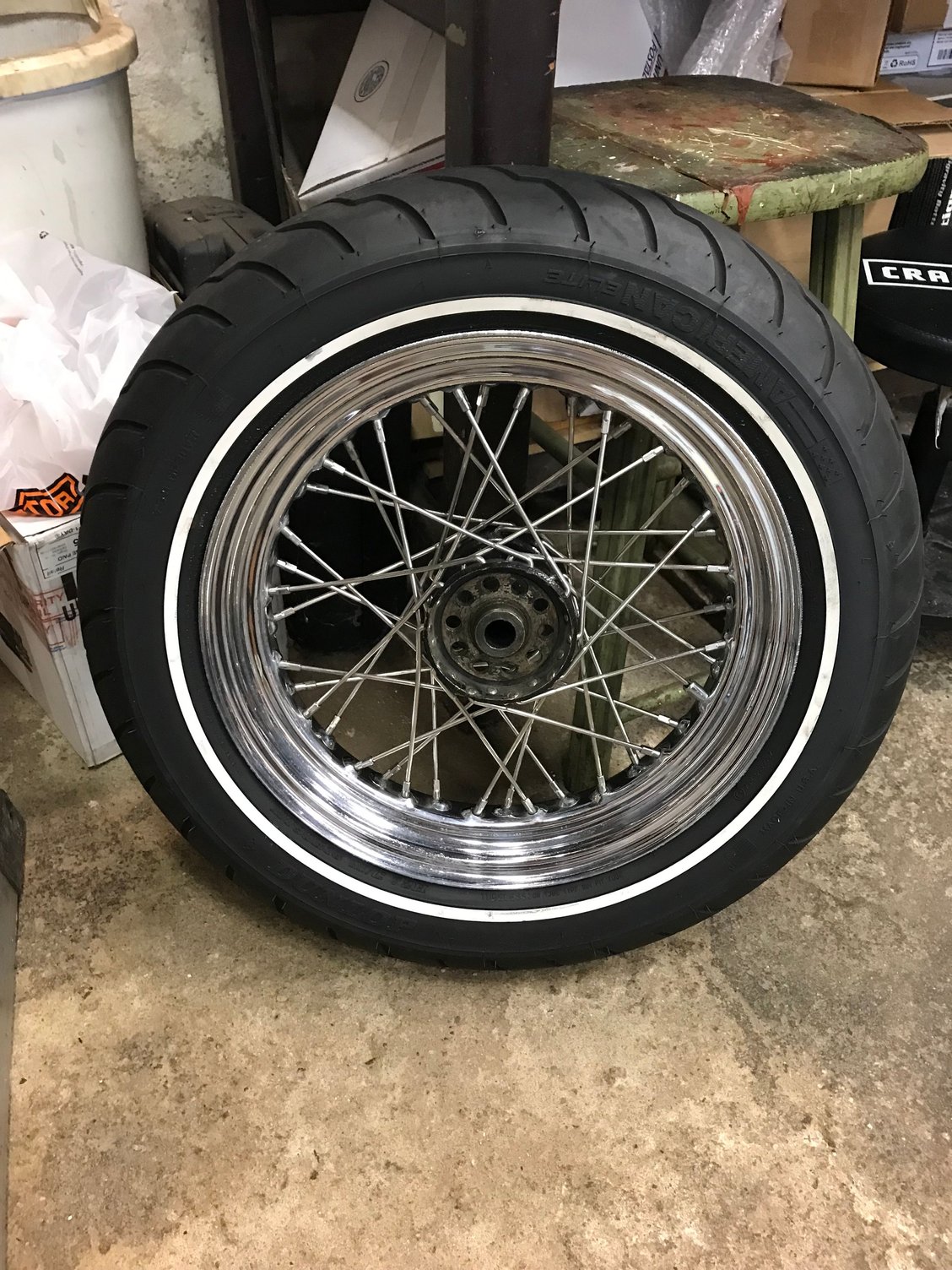

Original HD hub and rim with Buchannan spokes. Stainless for the win, good luck.
