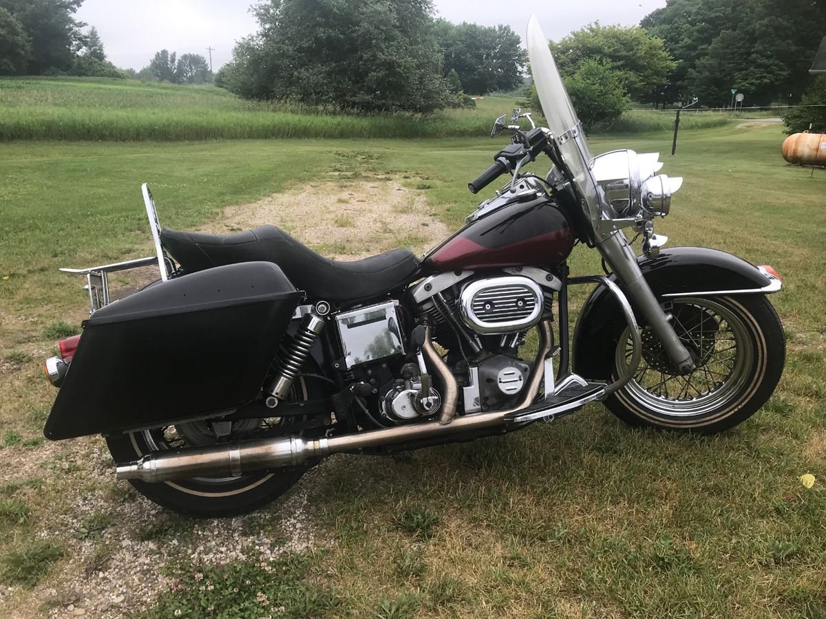

I use one
A 4-speed chassis is a 4-speed chassis

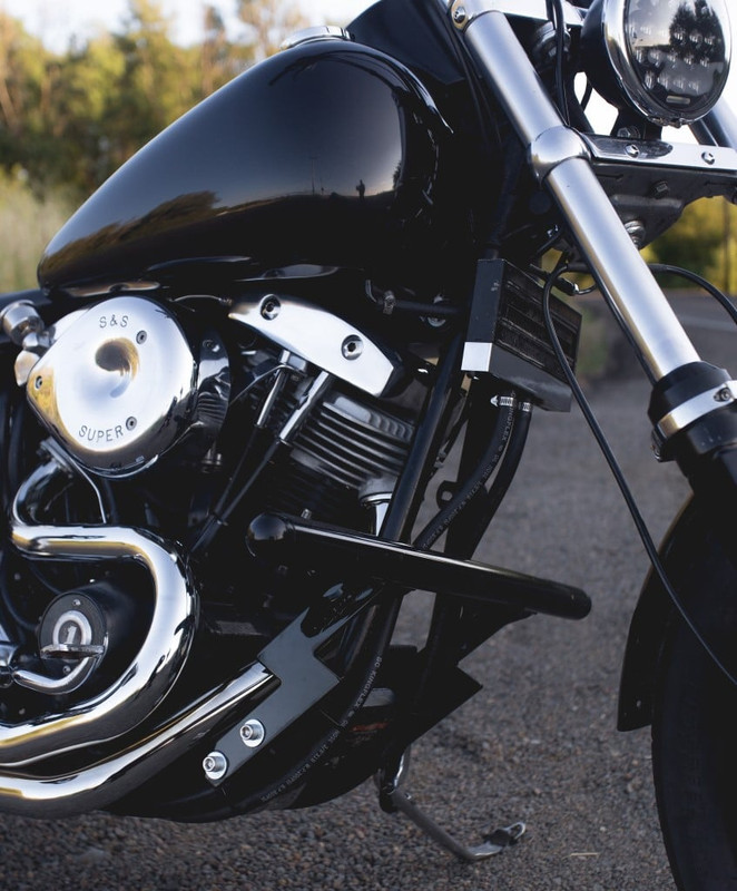

Anything is possible if you have the time and skill. Outside of that there aren’t many bolt on ones available outside of the common one for a Shovelhead posted above by Racepres:
https://vtwinvisionary.com/the-troub...us-shovelhead/
Not my bike but it’s a great custom outside of the normal Shovelhead builds.

In case you didn't get what they are saying, the crash bar from any FLH of that era will fit your bike.

Any 4-Speed... Not a "T" (5-speed)
