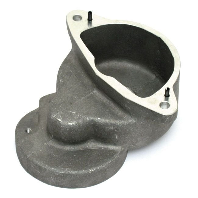

Twizted was referencing the small hole to the right of the bendix gear shaft in the photo, ignore the painted arrows.
yes, I am using a bendix viewer and watching while I am turning it over.

And AHDshovel does the starter reduction housing or the back of the primary boss have the same little alignment pins? The only possible way anything can be as low as you think is the cover or starter is missing those and is shifting. That's it, period, no other options outside things being totally and very obviously trashed from a major wreck or something .

See the 1/8" hole on the right just above the 1/4" one? should be a short pin in one of the 2 primarys, sometimes sticks in the outer. That's your alignment/ locating pin.
sorry I was paying attention to the painted arrows but on the right side of the bendix, yes my cover has the pin.

But again, make sure that alignment pin is there as the screws alone won't locate it properly.

I think I just realized the issue when using my partial cover to view the bendix my partial cover doesn’t have a pin
