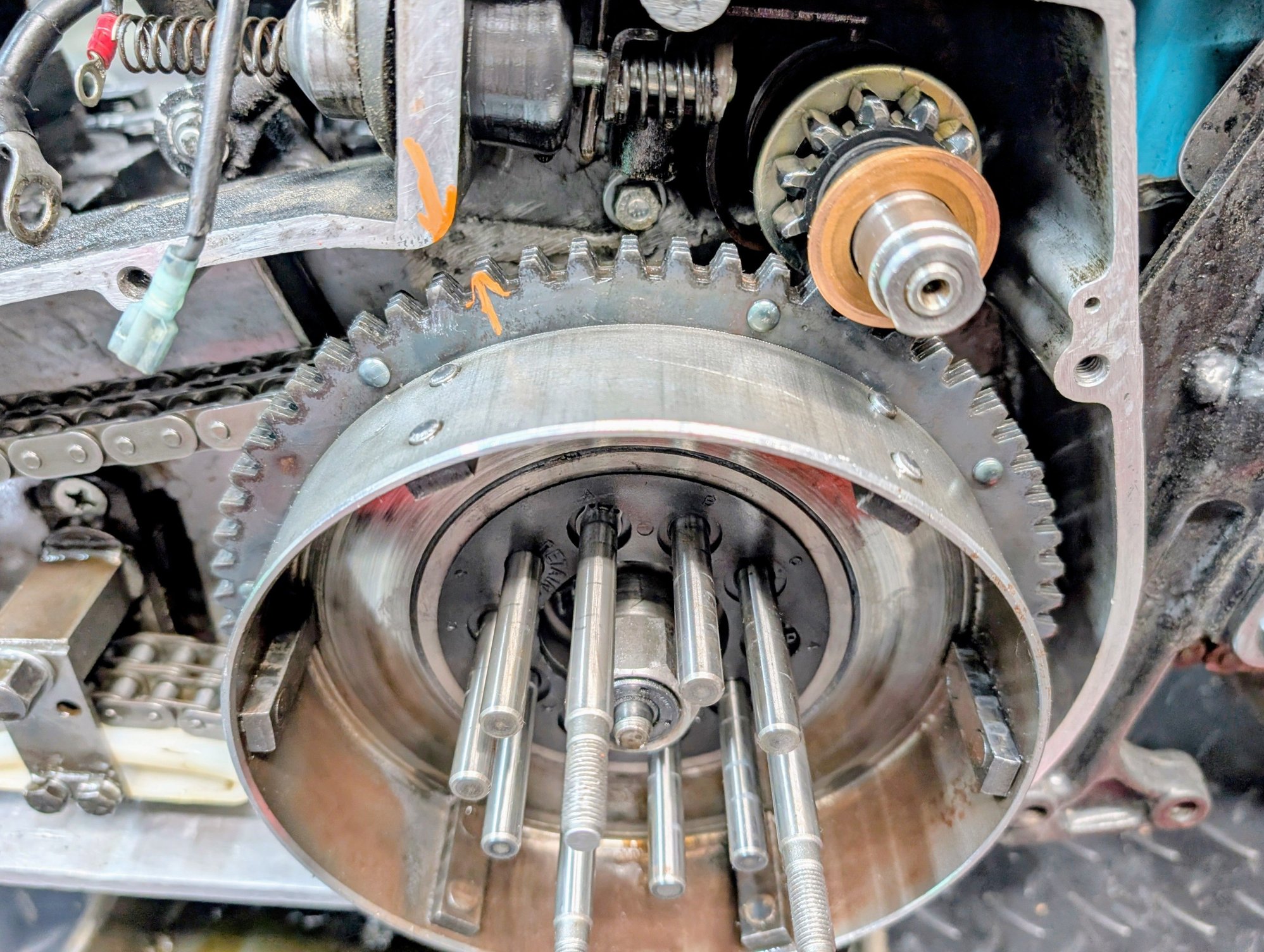

See the 1/8" hole on the right just above the 1/4" one? should be a short pin in one of the 2 primarys, sometimes sticks in the outer. That's your alignment/ locating pin.

Twizted was referencing the small hole to the right of the bendix gear shaft in the photo, ignore the painted arrows.
