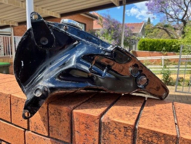

just bought these shovel tanks. but they have evo screw in caps any clues. did they come out like that in a certain yr ? thanks

My 5 gallon fat bob tanks ('83 FXWG) have screw-in caps.

Previous to about '82 they were Bayonet... Also, the Indentations inside surface, will tell you if Pan or Shovel!!!
If Not "molded" they are Aftermarket!

there are no stamps and welded all the edges

^^ When the Snow melts, I will carry my Phone out and compare!!

As far as I remember, all 5-gallon FLH tanks up to and including the 1984 model year were equipped with the typical "bayonet" fuel caps, both fuel caps were different and not interchangeable.

That round "dent" just above the rear mount is a good indication of O.E.
As is the "relief" for the Frame casting.. collar looking relief... But..My O.E. Shovel tanks are more "hollow" at the front, where that one is Slab sided at the very front.. Maybe Later??? I have a later set...different Building...later Date!!
I will Venture that Not many Aftermarket outfits went thru the Bother to relieve (contour) the backside..If they did...they were generally a Quality piece.. I will try to remember to study harder when up to other farm.. til then...I would Not loose too much sleep over the Quality of your Tanks..
