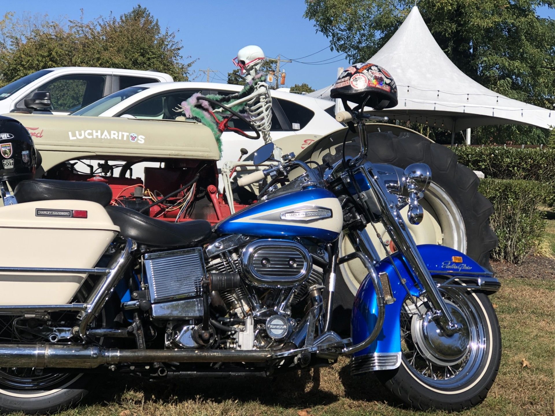

Hi everyone! Been "laid up" with heart issues on and off.... but I'm back!
Got a question I'm hoping for some of you have had experience in! My restored 1973 FLH police bike is pictured in this query for reference. I would like to convert it to kick start, leaving the electric start functional. I figure I will need to run "tru duels" for clearance. All very doable but my question is 1) What brand Kickstarter conversion is not junk...Between the big dealers and the auction retailers the prices are all over the place. 2) Are all the tru duels the same and will most of the common "dresser" shields work for them.
Lastly, I don't actually plan to use the kick starter....my knees are not great for this. I just want the nostalgia looks of it. So, do y'all think I'm being a fool and I ought to just leave the bike alone?????
All input would be appreciated!
My 1973 retored Elecrta Glide Police FL, Next to my
