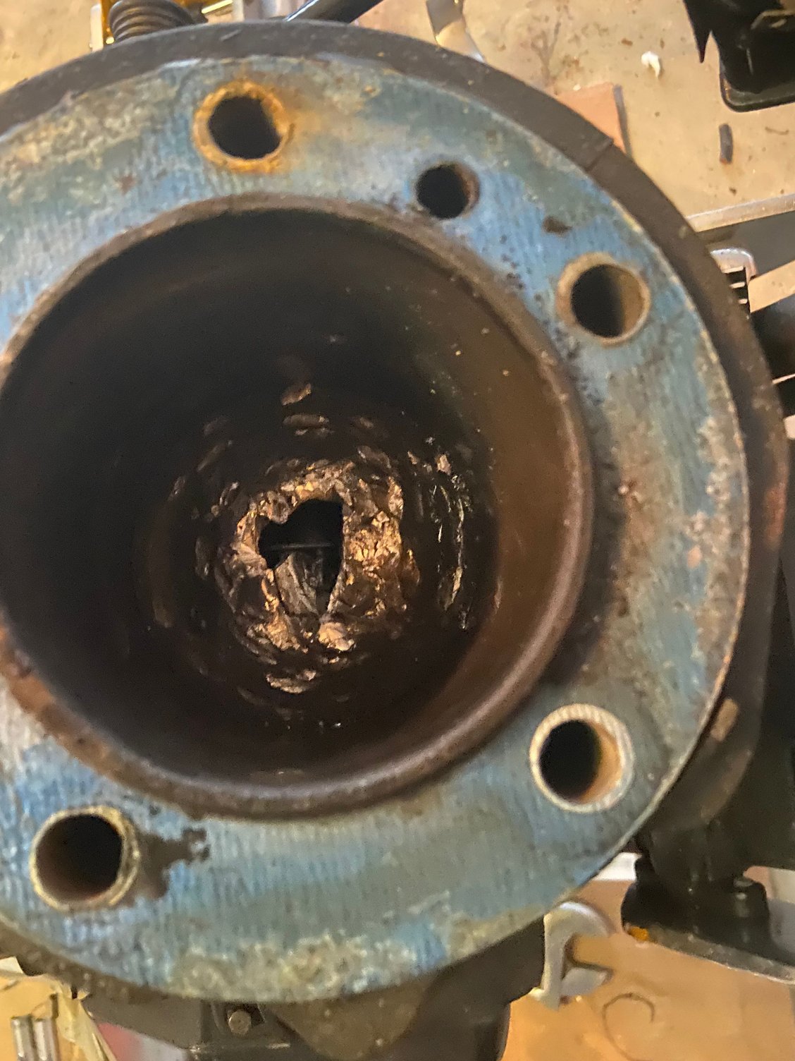

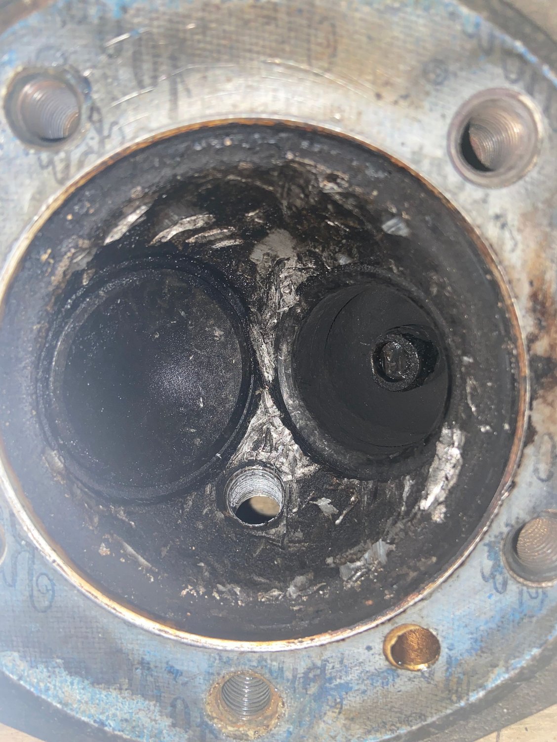

My Shovel was 38 years old when I bought it in 2020. It had almost 28K miles on it and was largely original. She started right up, ran well, and "felt" like it would do 65mph all day long. Had it in Sturgis in 2020 and was a lot of fun until the day before we were to head back. On the way to the Devil's tower in Wyoming the engine failed catastrophically. Long story short, the front cylinder exhaust valve face separated from valve stem. The reason was excessive wear in the valve guide. After enough time of the valve not hitting the seat squarely the valve fatigue failed. The point is that Shovel engines are only rated for 30K miles, you don't really know how the previous owner(s) maintained them and what the condition the insides are in. If you are looking at a Shovel, then you should consider having the heads pulled and checked over at the very least. Take it from me getting stuck literally in the middle of nowhere.
