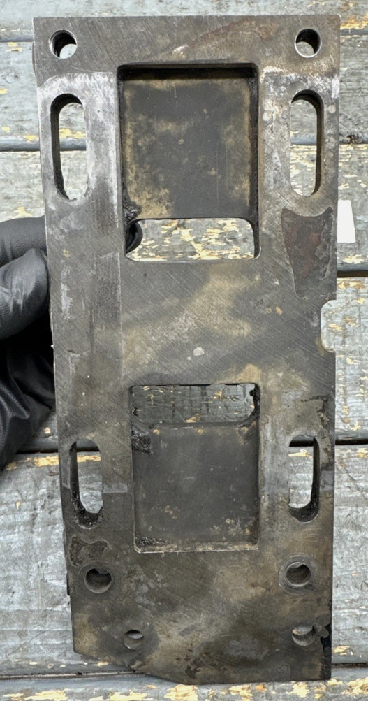

Likes: 671
I have a OEM transmission plate coming from a '66 shovel head. It appears to have been blancher ground by the machine marks in the surface. Will see how this fits in the frame when it gets here.

Got the early transmission mount today and it has the same amount of rock as the original.I will probably shim the low one because I do not have a good way to shorten the other rear post square.I also compared all dimensions to the OEM inner and they are all within .002". I won't shim at the front mount because it it is at a perfect 90 degree to the inner primary. I will need to cut off the angled rear section of the early mount to fit my application. Wish I had a band saw.

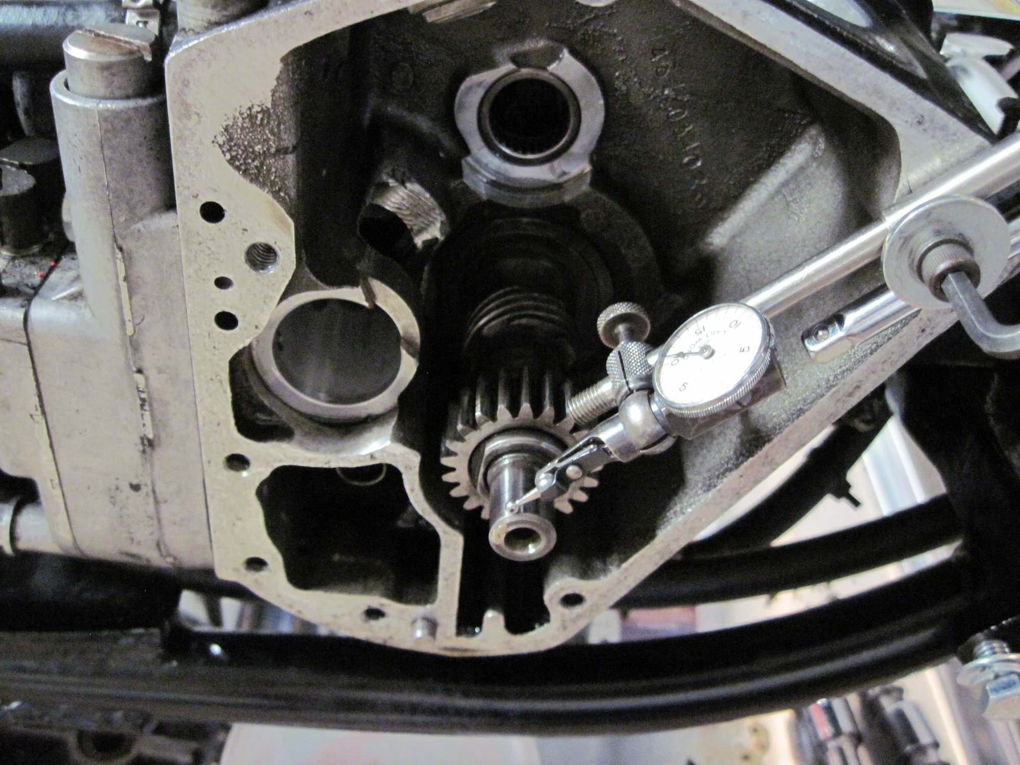

Pulled the cam cover to check things out. The bore for the breather is great, if one looks real close the cam is just starting to show just a little bit of pitting and the rollers on the lifters are tight and smooth. The bad part is that the run out on the end of the pinion gear shaft. is .024" and is way out of spec. The bushing in the cam cover looks good but I am thinking the crank needs to be trued up at least. The push rod on the rear intake was just shy of coming out when shortened all the way and I got it apart when I pulled the cam cover. So I need to check that out, so it looks like I will be pulling the engine.

Where did you read the spec on pinion shaft runout? The factory manual I have for 1978 1/2 to 1984 lists no such spec or at least I cannot find it in the book. As to your rear intake pushrod, mine is the same way and my engine had never been apart.
