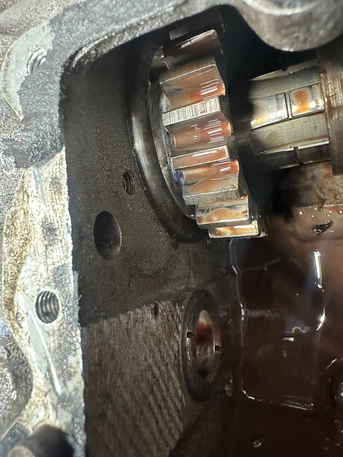

Trying to remove the main shaft. Things I’m reading and watching telling once I get the circlip off and slide 3rd gear over, I can just push the shaft through the kicker side.
it looks like the bearing race is too small to pass 1st gear. Am I missing something? Yes - I know the tranny is disgusting. That’s why I’m rebuilding it. It was in a parts pile. Thanks.

Figured it out. Had to line up first gear with the race and beat it out.

Was gonna say race comes out easy, why they do the big retainer all round it. In the middle of doing an upgrade for a gent on his 4 sp.
