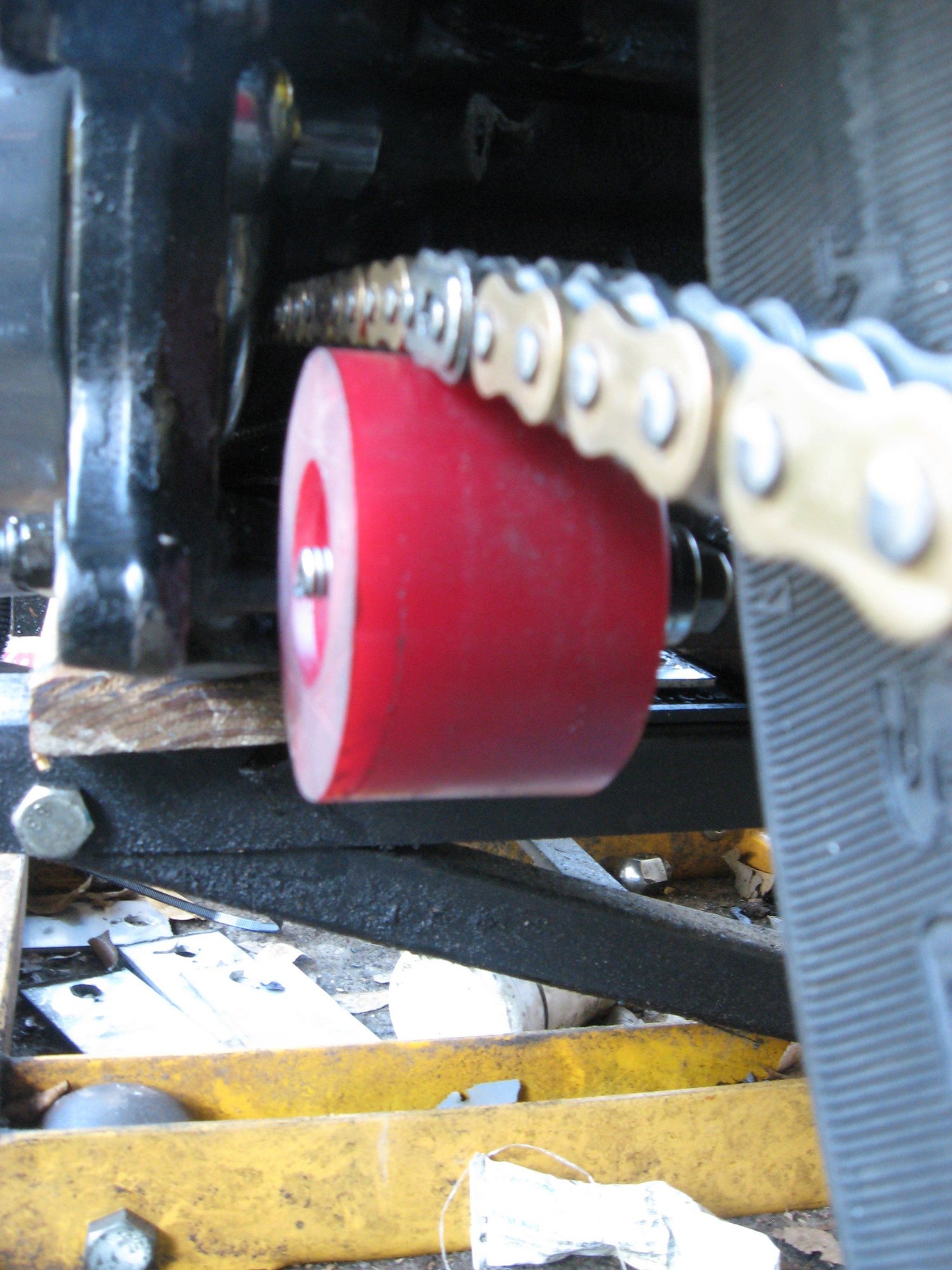

this is the rear chain tensioner-- keeps the chain from whipping -- makes a real smooth ride
Not interested in using a red roller skate wheel on my bike thanks.
