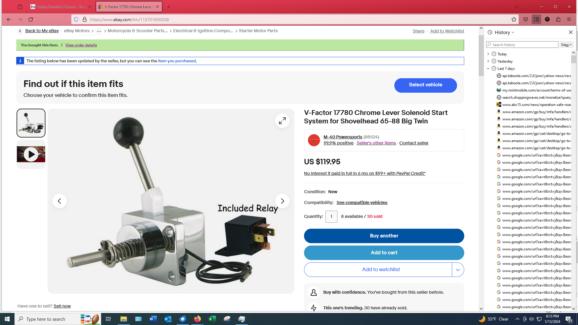

Default solution
never could get it to behave. another thread had a link to this. got one installed it happy days are here again. looks kind of retro.
read had a link to this. got one installed works great. Looks kind of retro.
