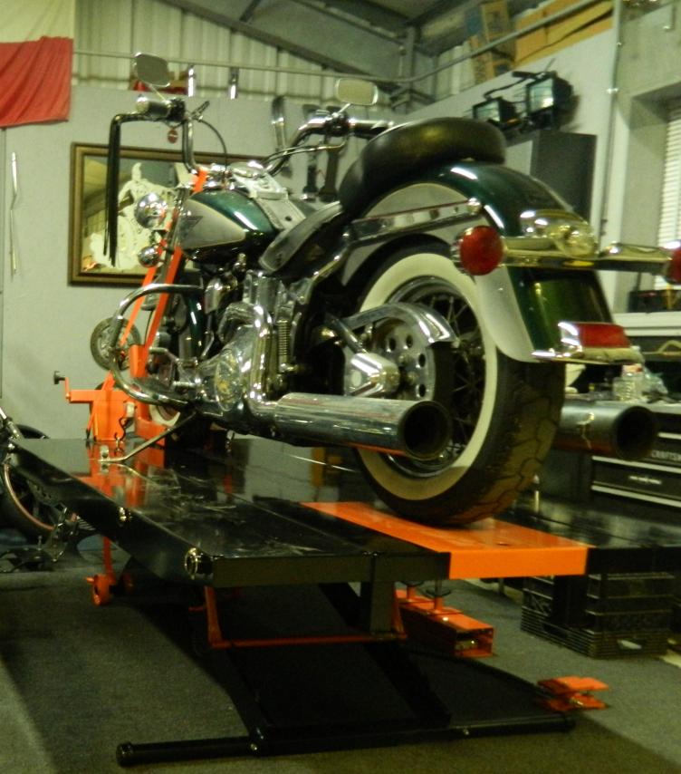

Standard boards (replaced today with some take-offs from my ultra) and standard shifter set-up.
Only thing I need to verify is the shift linkage has a 45* near the transmission lever to clear the true dual for the rear cylinder. I need to double-check if that is Harley design and if it allows proper travel. Surely it couldn't have been on for all these years and not functioned properly - but after seeing a couple of other things on this bike, I'll research it.
Side note nothing to do with the problem. I was going to eliminate the crashbar (nasty and flaking) going for an Old Skool look, but found out after removing it that the plate that supports the right side floorboard-master cylinder-and brake pedal, only has 1 3/8" bolt attaching it to the frame - so the crashbar is the second point of support structure. Bad design. Don't want to weld it to the frame, so new crashbar ordered.
Attached a Pic of my sons FLSTC.
Here's the one I'm working on.
Attached Thumbnails Neutral and down shift problem-eric-heritage.jpg   Neutral and down shift problem-009.jpg
