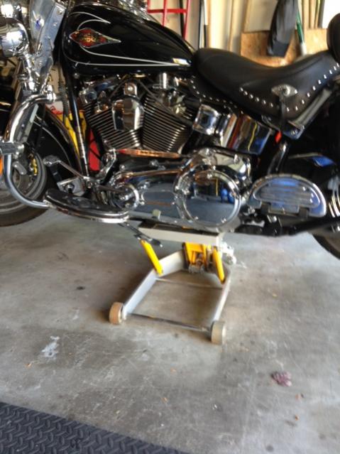

I used an idea I read here. Heater hose slit longwise. 1 inch inside diameter and Its 3/8 thick and thats thick enough that the jack doesnt touch the shocks. Advanced auto, $3.18.
Great minds must think alike.
The only difference is I used 3/4" hose and I got my hose from Auto Zone.
Works great and just gets the jack off the shocks.

The heater hose is a great cheap way to protect but, I have to wonder if they offer the same stability that the frame protectors, which aren't that expensive, offer.
After putting the hose on I found the stability no different than when the jack was directly on the frame.
That being said, I don't see anything wrong with the frame protectors and for $25 it ain't going to break the bank.
