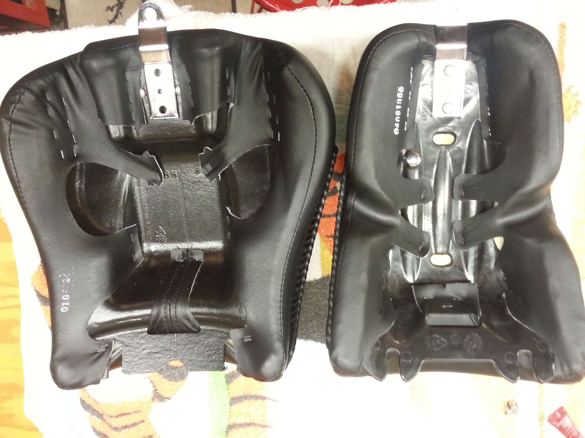

After several other mods, I am back to the pillion pad issue again. I'm still not quite sure I asked my question correctly. My concern is not any kind of way the large HD pillion pad, #52930-05, attaches to the bike or fender, but how it rests on the rear fender. The bottom of the seat is not flat allowing a flat rest on the fender like a pillow laying on a bed. It has two indentions at the rear portion of the bottom under the pad and those two indentions are what contacts the fender and should take the bulk of the weight. The stock luggage rack runs next to these indentions and out the back. Notice the seat indentions that rest on the fender. I thought that the rack may help spread the weight of the pad across the fender if the seat actually sits on the rack. I still want to use the seat with out the rack. It will be easier to put the seat on and off without the hassle of installing the stock rack each time, don't need it with the bags. I hope this makes sense. I will attach a pic of the bottom of both the stock and large pad. I hope to put a sheet of 3M clear bra on the fender as well. Thanks to all.

It is fine and does not need the rack for support. I have run mine that way many times. I have even put it on with my fender bib in place. I use the bib to cover the 2 rack holes and mount it under the front seat bracket and when I need the pillion I just put it on over that. No problem. BTW this is on my 2010 Deluxe.

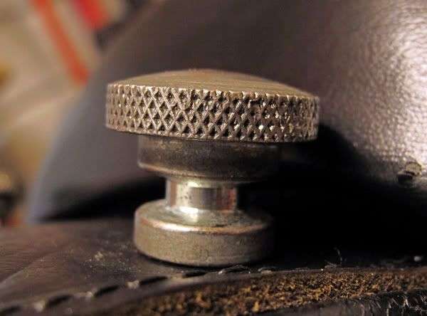

the two indentations are what holds the Front of the pilling to the bike they slide into the two nuts that hold the front seat down. Your chrome ones won't work..
the correct ones look like this one that holds the front of the Pillion seat in place....
the metal bracket with the hole for a screw in the rear of the pillion it what holds the pillion down to the fender...
