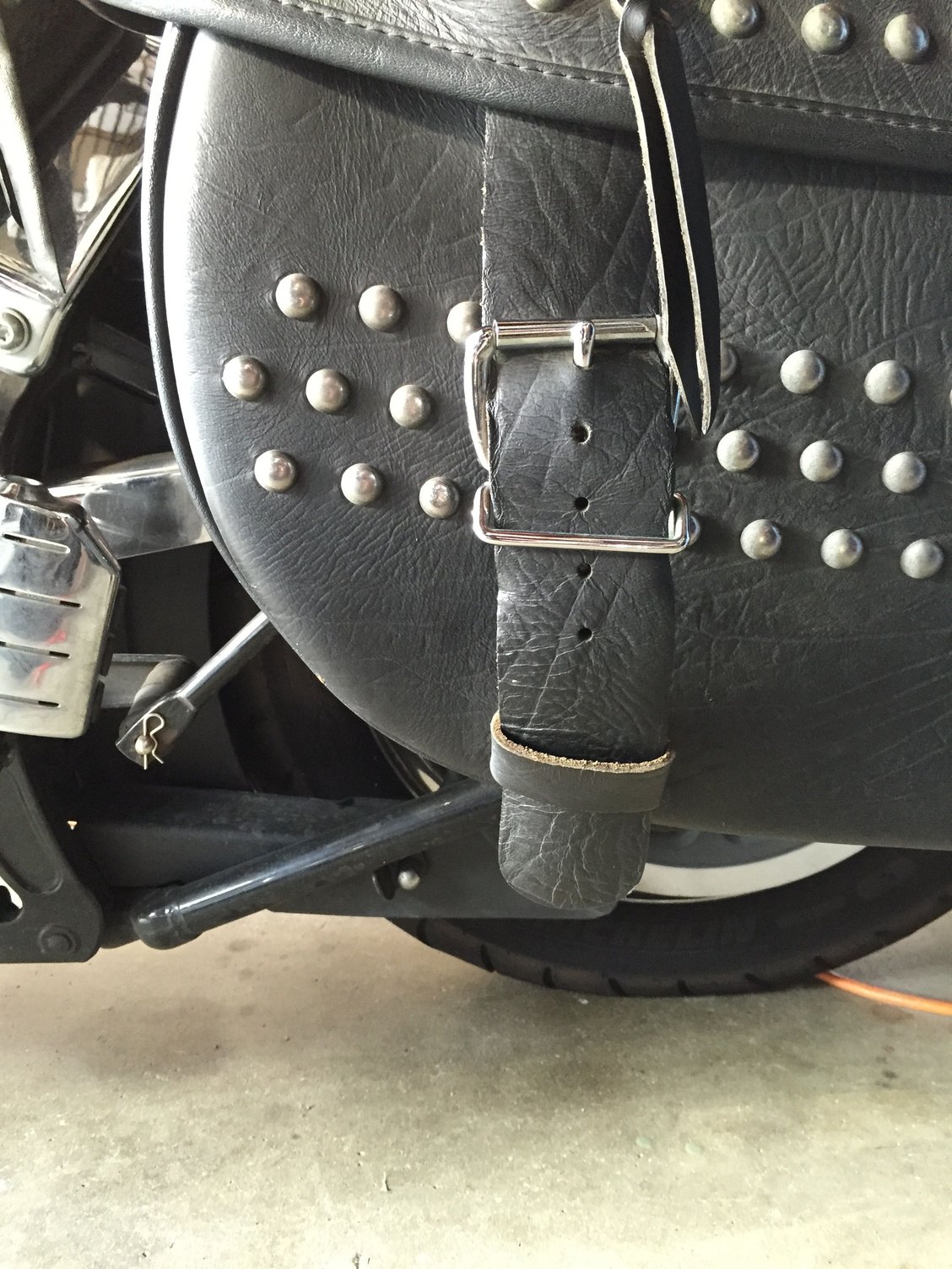

Also another way to fix the problem ...
I took an old belt the same or a little less as wide as the straps. Cut four pieces that was 1/8 thick by 4'' long and 1 1/2'' wide. Just enough to go between the end of the strap to just below the buckles.
Then used some Good leather glue (Amazing GOOP) is what I've found to be the best to bond them together Ends up being a 2 ply leather on the strap ends that is snug fitting and so stiff they won't blow out of you loops
this also works great and its been 5yrs ago when I did it, they won't / don't fly out any more either.
