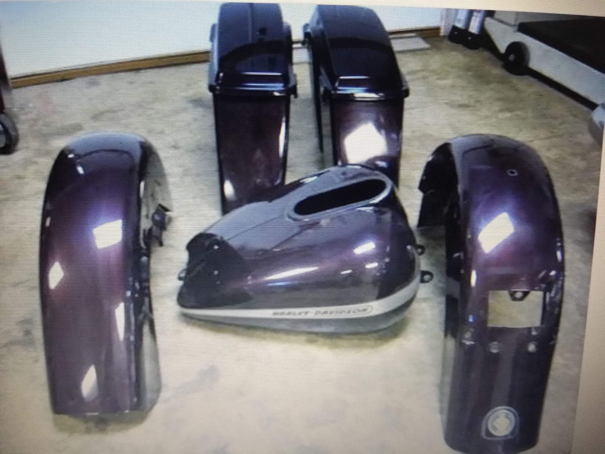

I found an ad on Craigslist for some touring tins for 97-08. Anybody know if these tins and hard bags would fit on an 08 Deluxe. Would I have to modify tins for a touring bike to fit a Softail?

Hmmm, well I know that the front fender has extenders on the side mounts to fit the wider forks. Not sure about the rest.

The short answer is no. The front fender brackets are a different height...the rear fender would require major mods to work...you can get brackets to make the bags work...not sure about the tank, but I would think it would be more trouble than it is worth.

That's what I needed to hear. Thank you
