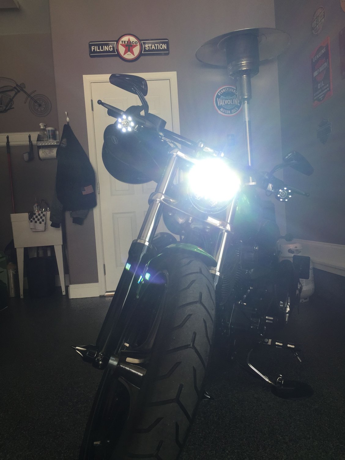

Since "Project Breakout" is an ongoing process I thought I'd post a pic of my latest addition. While at Myrtle Beach Bike Week, we saw these turn signal LED lights from custom dynamics. They are really cool. The LEDs are a white running light until the turn signals are activated, then the white lights turn off and the amber lights in the middle flash. I liked them so much I added them to all of our bikes.

Whats that wall decor on the back?
Is it a wrought Iron motorcycle, I need to get one for my garage...Need info on it pls

That came from Hobby Lobby.
