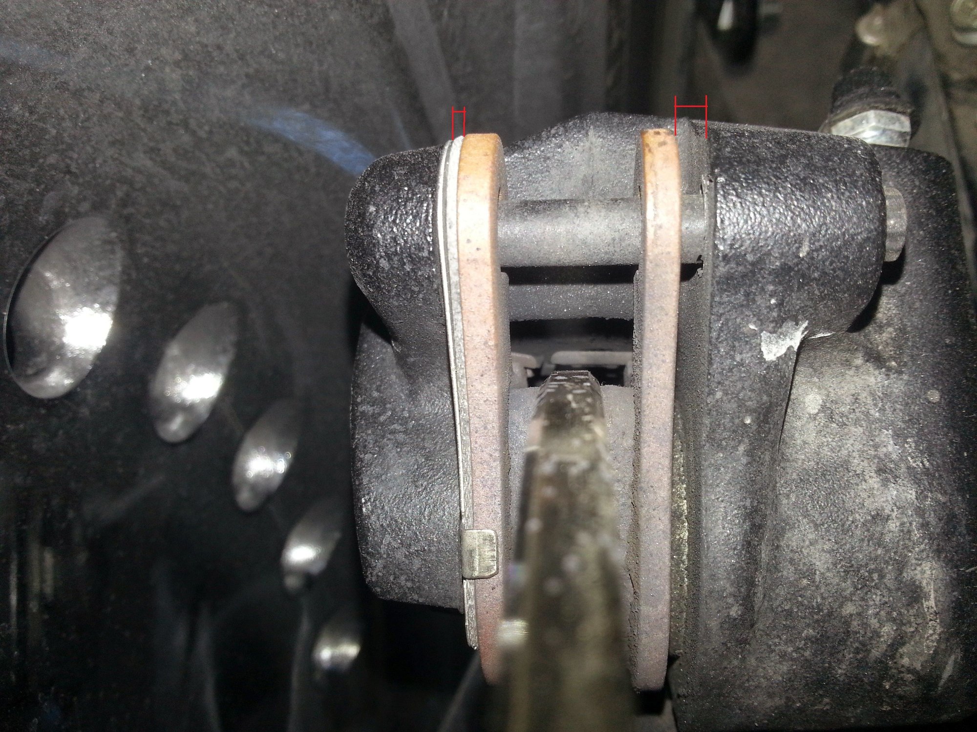

Hi,
I was looking at my 2014 FatBoy rear brake system and I realized that the distance between de break pads and the caliper housing are are not the same for left and right pads.
I saw that the right pad is much more distant from the caliper than the left one when the brake is not activated. Also, I realized that there is a part between the left pad and the caliper that I could not see at the right pad.
Attached there is a picture I took yesterday that shows what I am saying.
Is that normal or should I be concerned about my braking system or wheel alingment?
Thanks.

That is because the left pad is stationary. The pressure comes from the pistons in the caliper on the right.

Got it. Thanks for the quick an precise answer.
