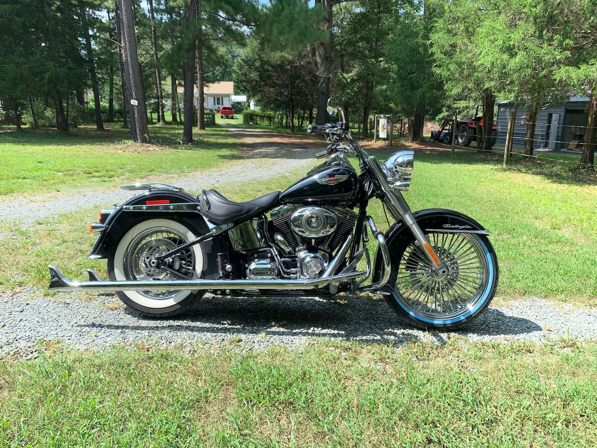

Installed DNA Fat Spokes with AVON White Wall in a little under an hour, with stock axle's and spacers.
From nearly Stock
To a little touch of me...
