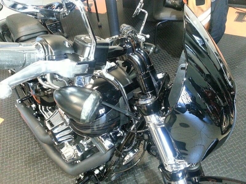

When people are talking about going to "1.75 inch risers" they are talking about putting on spacers in addition to the current risers- you can find them all over ebay- they add a little more height and a little closer reach to avoid some of the clamshell effect of the drag bars.
These pictured are the 1.75" spacers, powder coated black.
THANKS! I was pretty confused about that.... Do you by chance know the size of the stock risers? I'm thinking about making a run to the bike shop tomorrow morning to get a few parts. I found some 5.5-6" risers with and without extra pullback that I'm thinking about doing if the overall height is about the same as stock + extensions
I'd also like to do the whole mess in black if possible. Does anyone sell a gauge housing like the FXSB has in black? Otherwise I may end up piecing more things together. Is that a BO in the picture?
That's a BO in the picture. Once you go past 1.75" you need to extend all the cables on the BO. Even HD's "reduced reach" bars require new cabling (My dealer quoted me $1K for the whole changeover). I tried 1.5" spacers at first, but it still felt to me like I was riding a rice rocket, so I went with HD's "Mini Apes" and Magnum Black Pearl cables. Apes are just what the BO needs. Also, the speedo housing comes with HD's kit because it includes replacement risers.
