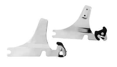

Amkaos...are these the ones that worked on your Heritage? What year is your bike?<br/>

Originally Posted by Pete3323
That's what it looks like my problem is. Guess I'll need to pony up for new side plates. Did yours work with the Heritage bags once you got the notched plates?
Yeah, ...I had the quick mount docks already cuz I have a touring trunk that quick mounts..so they make everything quick mount.. bottom line, sounds to me like you need new side plates
