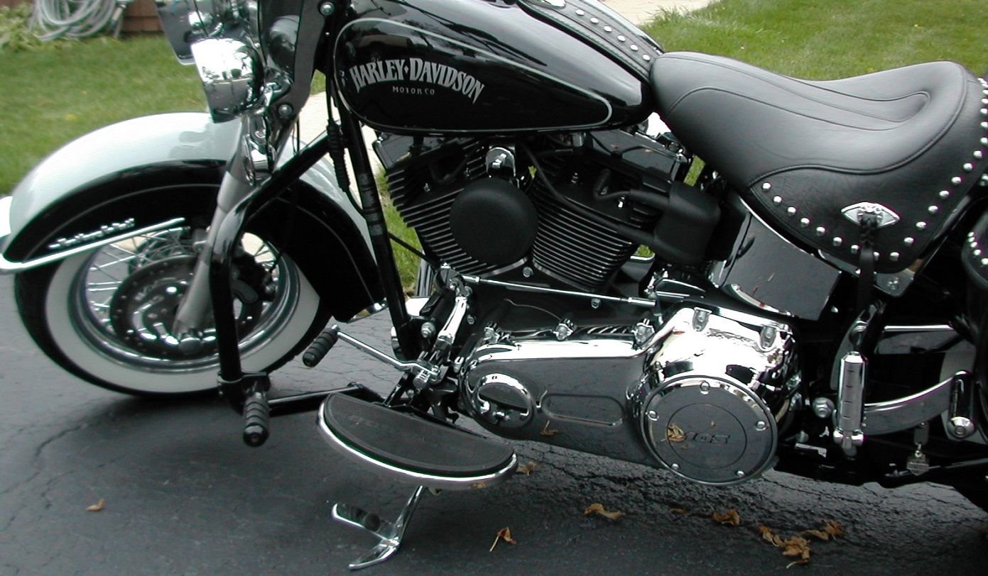

I have but one shifter on my Road King. I removed heel shifter and took the rubber piece off it to cut down and use as a spacer. I put that between the primary case and the remaining toe shifter that I positioned on the end of the shaft where the heel shifter was. That makes it easier to get to and I don't have the shaft with a cap on it in my instep when shifting.
