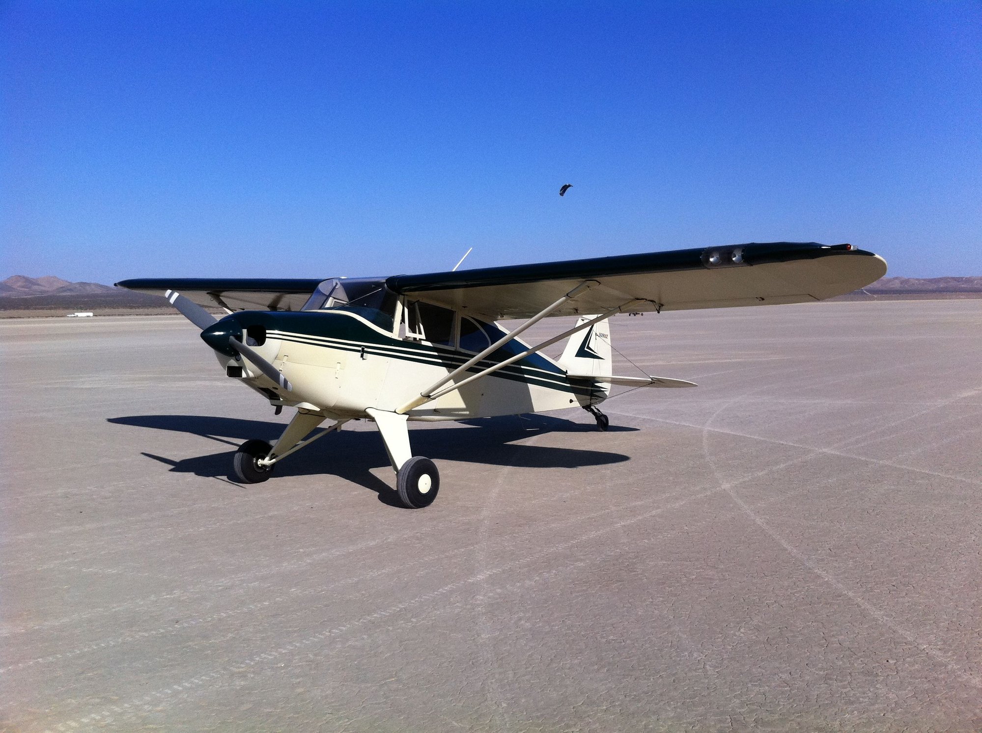

The tail wheel bearings on my '59 Pacer are lubed exactly the same way. Fill the hollow axle with grease until new grease flows out the ends. Fresh grease is now in the bearings. Since I land on dirt tracks and dry lakes, the tail wheel gets VERY dirty.

Where are you with the pacer? That is a beautiful bird. I just relocated to Florida and was over looking into rentals by me. Best I can find is a Tecnam Lightsport at $109 wet.

Pacer is a great short field plane. I meet up with friends in motorhomes for dirt bike riding, firing weapons and scale rockets. The plane has plenty of space to bring my dog. Not a Harley but a fun bike for the dirt my friend brought along with his bikes.
The Prop blows lots of dust and dirt on the tail wheel. The horizontal bearings that let the tail wheel swivel have a similar grease fitting, and both get plenty of regular servicing, so grease is always oozing like the first steering head shot in this link. Sorry for the thread hijack.
