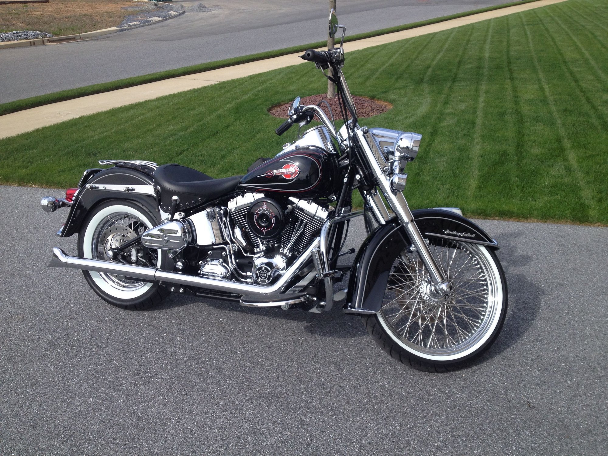

I just installed a 21" on my Heritage and don't find any issue with the ride. Still comfortable and looks good…..
